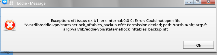

The visible Eddie error is essentially:
Could not open file: /var/lib/eddie-vpn/state/netlock_nftables_backup.nft Permission denied

The problem is still the same. Network Lock fails and Eddie reports that it cannot open /var/lib/eddie-vpn/state/netlock_nftables_backup.nft because of a permission denied error.
I also checked the SELinux audit log from the same attempt. This time it only logged two rawip_socket denials for eddie-cli-eleva. The older additional SELinux denials involving nft and rename/unlink did not appear again in this run.

Unfortunately the issue is still present. Network Lock fails with the same permission denied error for /var/lib/eddie-vpn/state/netlock_nftables_backup.nft.
This time SELinux also showed the warning directly, and the AVC log contains the file-related denials again. In addition to the rawip_socket denials, there are rename/unlink denials involving resolv.conf and getattr denials for nft accessing netlock_nftables_backup.nft.
