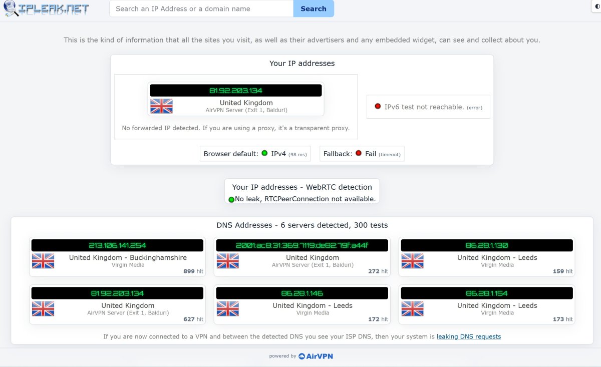

I keep ipleak.net in my Firefox browser's bookmarks toolbar, and I check it probably every one or two weeks. In the past, with eddie enabled, I only see an Air VPN server in the DNS addresses. Today, I can also see DNS servers for my ISP.
I get the same result if I switch to Microsoft Edge, or to my other desktop PC. (Both PCs are Dell Inspiron 3030s with identical build and software.)
And can someone please remind me of the correct tags to use on this forum to conceal text. I will then edit the post.

@after_lunch
Thank you for the complete report, it shows what is happening.
Your Wi-Fi adapter gets its DNS servers from your router: 194.168.4.100 and 194.168.8.100, which are your ISP's resolvers. Eddie 2.26.2 sets the AirVPN DNS (10.128.0.1) only on its own adapter, and in some circumstances its DNS leak protection fails to block queries sent to the resolvers of the other adapters. This is a known bug of 2.26.2, and your report matches it: Network Lock is active and the log says "DNS leak protection with packet filtering enabled", yet Windows still reaches your ISP's resolvers.
You can solve it in one of two ways:
1. Stay on 2.26.2 and apply a workaround: open Eddie's Preferences > DNS, enable "Force all network interfaces for DNS", save, then disconnect and reconnect.
OR
2. Upgrade to Eddie 2.27.2 beta, which contains the fix:
https://airvpn.org/forums/topic/81340-eddie-desktop-edition-227-beta-released/
Then repeat the test on ipleak.net while connected: only AirVPN DNS servers should be listed. If your ISP's resolvers still appear after the workaround, please switch to 2.27.2, and if they persist there too, post a new system report.
About hiding long text: the forum does not convert spoiler tags typed by hand. Use the Spoiler button in the editor toolbar and paste the text inside the box that appears, or simply attach the report as a .txt file.
Thanks, Staff. I've upgraded to 2.27.2 beta on both PCs, and that has indeed fixed the DNS server problem: ipleak.net now only shows AirVPN DNS servers. I've included a new System Report for info.
And thanks also for the help with hiding long text! 😊
