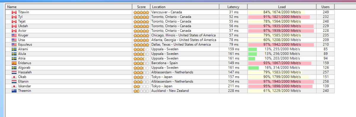

bilis 1 Posted ... I have noticed that the latest days i see less and less servers and countries available. Is there a problem? Is there something i am doing wrong? 1 bienvenue92 reacted to this Quote Share this post Link to post
riotamus 0 Posted ... i got 18 servers from the entire world, instead of the usual several pages. the two that are close enough are 95% full, so they are dangerously close to being unavailable. is it a hiccup or a new normal? Quote Share this post Link to post
Harold99_0 1 Posted ... What happened to all the servers? A few months ago some of the NY servers vanished from my list. So I started using Canadian servers. Now there are only 8 servers showing up in Eddie. 3 US servers and 5 Canadian servers. I haven't touched anything in Eddie. It remains exactly the same as it's always been. And I had a few London servers added to my list for the heck of it. Those are just gone all together. What happened to all the servers? 1 bienvenue92 reacted to this Quote Share this post Link to post

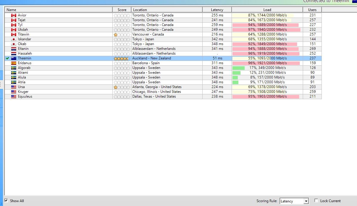

zeedatrup 0 Posted ... Hi Community, For some reason I am only getting access to 18 servers, I have noticed the number of available servers has been dropping off lately, today being the worst. I have lodged a support ticket but was unable to attach a screenshot of the server tab in eddie showing the limited server access. See below. Any ideas of what I may be doing wrong. cheers, zeedatrup Quote Share this post Link to post
Veep Peep 14 Posted ... I see much fewer than I am used to. The block list is cleared. Help? Quote Share this post Link to post
Staff 10693 Posted ... @bilis @riotamus @Harold99_0 @sebalpatine @zeedatrup @Veep Peep Hello! A plausible explanation is that you're running an obsolete Eddie Desktop edition version. Eddie filters out servers whose connection mode is not compatible with your system setup. For example, as DCO support is completed throughout the whole infrastructure, an old Eddie version not supporting WireGuard and running an OpenVPN version 2.3.x will be unable to find a suitable server. Please upgrade your Eddie Desktop edition and report back at your convenience. If you are not running Eddie Desktop edition, please specify the software you're running. Kind regards 1 zeedatrup reacted to this Quote Share this post Link to post
