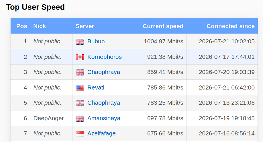

Staff 10693 Posted ... Hello! For the readers and OP: @mith_y2k had a dramatic performance boost by setting WireGuard MTU to 1280 bytes (from previous 1420 bytes) and by cherry picking servers around his/her location instead of picking a generic continent and let the domain name extract the "best" server. Support team is now considering whether suggesting to add MSS clamping too, in case PMTUD is broken somewhere, but the throughput is now consistent with the "Top 100 Users Speed" so the MTU was for sure the main problem. About server selection, always consider that if you use an entire continent domain name, you are in a sub optimal situation to find the server that can provide you with the best performance. The domain name resolution takes into account important variables to resolve into the entry IP address of an healthy server, but knows absolutely nothing about your location, routing and round trip time from your node to the VPN server. Therefore, when you select an entire continent, you shrink the likelihood of finding a server that's indeed the best for throughput to/from your node. Kind regards Quote Share this post Link to post
