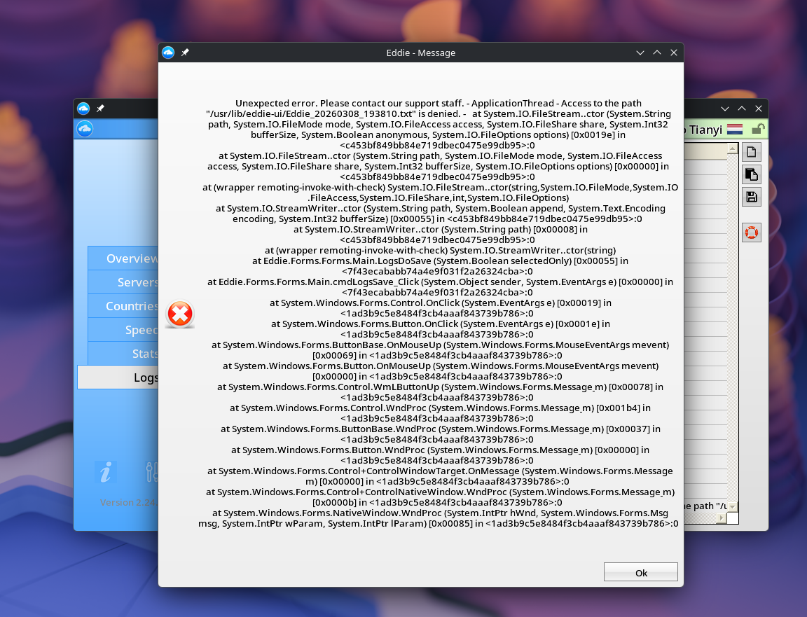

for some reason, my brain decided to try to save it to where eddie was, which also caused an additional error at the end of the first report.
the second one in bytes is the network lock error.

F 2026.03.08 19:38:13 - Unexpected error. Please contact our support staff. - ApplicationThread - Access to the path "/usr/lib/eddie-ui/Eddie_20260308_193810.txt" is denied. -   at System.IO.FileStream..ctor (System.String path, System.IO.FileMode mode, System.IO.FileAccess access, System.IO.FileShare share, System.Int32 bufferSize, System.Boolean anonymous, System.IO.FileOptions options) [0x0019e] in <c453bf849bb84e719dbec0475e99db95>:0
F 2026.03.08 19:38:13 -     at System.IO.FileStream..ctor (System.String path, System.IO.FileMode mode, System.IO.FileAccess access, System.IO.FileShare share, System.Int32 bufferSize, System.IO.FileOptions options) [0x00000] in <c453bf849bb84e719dbec0475e99db95>:0
F 2026.03.08 19:38:13 -     at (wrapper remoting-invoke-with-check) System.IO.FileStream..ctor(string,System.IO.FileMode,System.IO.FileAccess,System.IO.FileShare,int,System.IO.FileOptions)
F 2026.03.08 19:38:13 -     at System.IO.StreamWriter..ctor (System.String path, System.Boolean append, System.Text.Encoding encoding, System.Int32 bufferSize) [0x00055] in <c453bf849bb84e719dbec0475e99db95>:0
F 2026.03.08 19:38:13 -     at System.IO.StreamWriter..ctor (System.String path) [0x00008] in <c453bf849bb84e719dbec0475e99db95>:0
F 2026.03.08 19:38:13 -     at (wrapper remoting-invoke-with-check) System.IO.StreamWriter..ctor(string)
F 2026.03.08 19:38:13 -     at Eddie.Forms.Forms.Main.LogsDoSave (System.Boolean selectedOnly) [0x00055] in <7f43ecababb74a4e9f031f2a26324cba>:0
F 2026.03.08 19:38:13 -     at Eddie.Forms.Forms.Main.cmdLogsSave_Click (System.Object sender, System.EventArgs e) [0x00000] in <7f43ecababb74a4e9f031f2a26324cba>:0
F 2026.03.08 19:38:13 -     at System.Windows.Forms.Control.OnClick (System.EventArgs e) [0x00019] in <1ad3b9c5e8484f3cb4aaaf843739b786>:0
F 2026.03.08 19:38:13 -     at System.Windows.Forms.Button.OnClick (System.EventArgs e) [0x0001e] in <1ad3b9c5e8484f3cb4aaaf843739b786>:0
F 2026.03.08 19:38:13 -     at System.Windows.Forms.ButtonBase.OnMouseUp (System.Windows.Forms.MouseEventArgs mevent) [0x00069] in <1ad3b9c5e8484f3cb4aaaf843739b786>:0
F 2026.03.08 19:38:13 -     at System.Windows.Forms.Button.OnMouseUp (System.Windows.Forms.MouseEventArgs mevent) [0x00000] in <1ad3b9c5e8484f3cb4aaaf843739b786>:0
F 2026.03.08 19:38:13 -     at System.Windows.Forms.Control.WmLButtonUp (System.Windows.Forms.Message& m) [0x00078] in <1ad3b9c5e8484f3cb4aaaf843739b786>:0
F 2026.03.08 19:38:13 -     at System.Windows.Forms.Control.WndProc (System.Windows.Forms.Message& m) [0x001b4] in <1ad3b9c5e8484f3cb4aaaf843739b786>:0
F 2026.03.08 19:38:13 -     at System.Windows.Forms.ButtonBase.WndProc (System.Windows.Forms.Message& m) [0x00037] in <1ad3b9c5e8484f3cb4aaaf843739b786>:0
F 2026.03.08 19:38:13 -     at System.Windows.Forms.Button.WndProc (System.Windows.Forms.Message& m) [0x00000] in <1ad3b9c5e8484f3cb4aaaf843739b786>:0
F 2026.03.08 19:38:13 -     at System.Windows.Forms.Control+ControlWindowTarget.OnMessage (System.Windows.Forms.Message& m) [0x00000] in <1ad3b9c5e8484f3cb4aaaf843739b786>:0
F 2026.03.08 19:38:13 -     at System.Windows.Forms.Control+ControlNativeWindow.WndProc (System.Windows.Forms.Message& m) [0x0000b] in <1ad3b9c5e8484f3cb4aaaf843739b786>:0
F 2026.03.08 19:38:13 -     at System.Windows.Forms.NativeWindow.WndProc (System.IntPtr hWnd, System.Windows.Forms.Msg msg, System.IntPtr wParam, System.IntPtr lParam) [0x00085] in <1ad3b9c5e8484f3cb4aaaf843739b786>:0

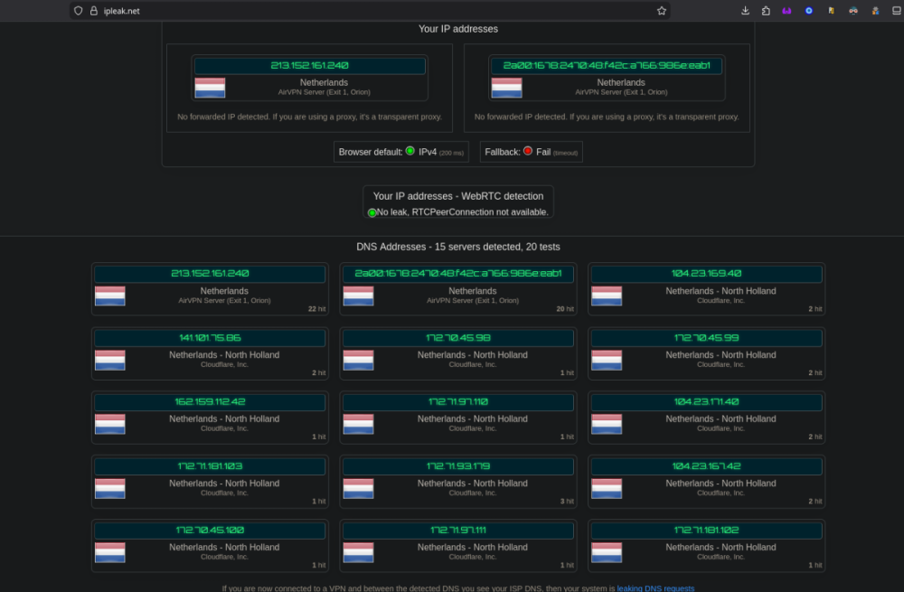

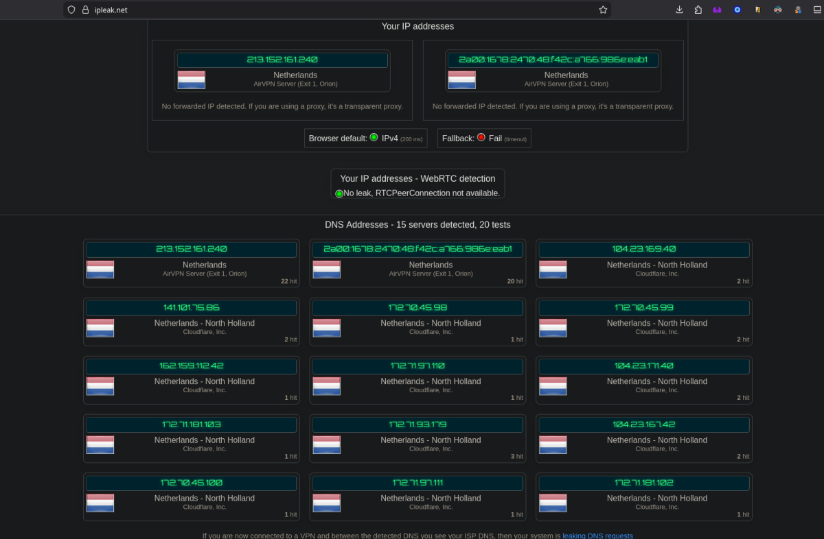

Thank you for the transparency. You should have specified 'why' it wasn't enough to begin with. sorry. I feel at least like a line that says in all bold "Saving the log will not have the same effect as uploading it bc it doesn't have all that extra data" should be added to that, to help avoid idiots like me lmao.
Here is the full report, not going to censor anything bc
a. it isn't where i live
b. and this isn't my name lol
Eddie System/Environment Report - 3/15/2026 - 10:49 AM UTC
Eddie version: 2.24.6
Eddie OS build: linux_x64
Eddie architecture: x64
OS type: Linux
OS name: openSUSE Tumbleweed
OS version: 20260304
OS architecture: x64
Framework: 6.8.0.96 (tarball Wed Jan 15 10:20:48 UTC 2020); Framework: v4.0.30319
OpenVPN: 2.6.14 - OpenSSL 3.5.3 16 Sep 2025, LZO 2.10 (/sbin/openvpn)
Hummingbird: Not available
WireGuard: Not available
SSH: OpenSSH_10.2p1, OpenSSL 3.5.3 16 Sep 2025 (/usr/bin/ssh)
SSL: Not available
Profile path: /home/zayn/.config/eddie/default.profile
Data path: /home/zayn/.config/eddie
Application path: /usr/lib/eddie-ui
Executable path: /usr/lib/eddie-ui/eddie-ui
Command line arguments: (1 args) path.resources="/usr/share/eddie-ui"
Network Lock Active: No
Connected to VPN: Yes, Merga
OS support IPv4: Yes
OS support IPv6: Yes
Detected DNS: 10.128.0.1,fd7d:76ee:e68f:a993::1
Test DNS IPv4: Ok
Test DNS IPv6: Ok
Test Ping IPv4: 102 ms
Test Ping IPv6: 101 ms
Test HTTP IPv4: Error: Fetch url error:Could not connect to server
Test HTTP IPv6: Error: Fetch url error:Could not connect to server
Test HTTPS: Ok
Important options not at defaults:
login: (omissis)
password: (omissis)
remember: True
key: (omissis)
areas.allowlist: ca,nl,cz
areas.denylist: de,us,at,gb,tw
proxy.mode: none
netlock.connection: False
netlock.allow_private: False
netlock.allow_ping: False

. 2026.03.15 11:40:51 - DNS of the system restored - via /etc/resolv.conf)
. 2026.03.15 11:40:51 - Collect network information
. 2026.03.15 11:40:51 - Connection terminated.
I 2026.03.15 11:40:51 - Checking authorization ...
! 2026.03.15 11:40:52 - Connecting to Musica (Netherlands, Alblasserdam)
. 2026.03.15 11:40:52 - Routes, add 213.152.161.251/32 for interface "wlp3s0".
. 2026.03.15 11:40:52 - WireGuard > Setup start
. 2026.03.15 11:40:52 - WireGuard > Setup complete
. 2026.03.15 11:40:52 - WireGuard > Setup interface
. 2026.03.15 11:40:53 - WireGuard > Received first handshake
. 2026.03.15 11:40:53 - DNS of the system switched to VPN DNS - via /etc/resolv.conf)
. 2026.03.15 11:40:53 - Routes, add 0.0.0.0/1 for interface "Eddie".
. 2026.03.15 11:40:53 - Routes, add 128.0.0.0/1 for interface "Eddie".
. 2026.03.15 11:40:53 - Routes, add ::/1 for interface "Eddie".
. 2026.03.15 11:40:53 - Routes, add 8000::/1 for interface "Eddie".
. 2026.03.15 11:40:53 - Routes, add 213.152.161.249/32 for interface "Eddie".
. 2026.03.15 11:40:53 - Routes, add 2a00:1678:2470:50:4fbf:b745:133a:e951/128 for interface "Eddie".
. 2026.03.15 11:40:53 - Flushing DNS
I 2026.03.15 11:40:53 - Checking route IPv4
I 2026.03.15 11:40:54 - Checking route IPv6
I 2026.03.15 11:40:54 - Checking DNS
. 2026.03.15 11:40:55 - Collect network information
! 2026.03.15 11:40:55 - Connected.
! 2026.03.15 11:43:43 - Disconnecting
. 2026.03.15 11:43:44 - WireGuard > Stop request received
. 2026.03.15 11:43:44 - WireGuard > Stopping
. 2026.03.15 11:43:44 - WireGuard > Completed
. 2026.03.15 11:43:44 - Routes, delete 0.0.0.0/1 for interface "Eddie", not exists.
. 2026.03.15 11:43:44 - Routes, delete 128.0.0.0/1 for interface "Eddie", not exists.
. 2026.03.15 11:43:44 - Routes, delete ::/1 for interface "Eddie", not exists.
. 2026.03.15 11:43:44 - Routes, delete 8000::/1 for interface "Eddie", not exists.
. 2026.03.15 11:43:44 - Routes, delete 213.152.161.251/32 for interface "wlp3s0".
. 2026.03.15 11:43:44 - Routes, delete 213.152.161.249/32 for interface "Eddie", not exists.
. 2026.03.15 11:43:44 - Routes, delete 2a00:1678:2470:50:4fbf:b745:133a:e951/128 for interface "Eddie", not exists.
. 2026.03.15 11:43:44 - DNS of the system restored - via /etc/resolv.conf)
. 2026.03.15 11:43:44 - Collect network information
. 2026.03.15 11:43:45 - Connection terminated.
. 2026.03.15 11:43:45 - Flushing DNS
! 2026.03.15 11:43:45 - Session terminated.
I 2026.03.15 11:49:44 - Session starting.
I 2026.03.15 11:49:44 - Checking authorization ...
! 2026.03.15 11:49:44 - Connecting to Merga (Netherlands, Alblasserdam)
. 2026.03.15 11:49:44 - Routes, add 213.152.161.32/32 for interface "wlp3s0".
. 2026.03.15 11:49:44 - WireGuard > Setup start
. 2026.03.15 11:49:44 - WireGuard > Setup complete
. 2026.03.15 11:49:44 - WireGuard > Setup interface
. 2026.03.15 11:49:45 - WireGuard > Received first handshake
. 2026.03.15 11:49:45 - DNS of the system switched to VPN DNS - via /etc/resolv.conf)
. 2026.03.15 11:49:45 - Routes, add 0.0.0.0/1 for interface "Eddie".
. 2026.03.15 11:49:45 - Routes, add 128.0.0.0/1 for interface "Eddie".
. 2026.03.15 11:49:45 - Routes, add ::/1 for interface "Eddie".
. 2026.03.15 11:49:45 - Routes, add 8000::/1 for interface "Eddie".
. 2026.03.15 11:49:45 - Routes, add 213.152.161.30/32 for interface "Eddie".
. 2026.03.15 11:49:46 - Routes, add 2a00:1678:2470:42:e8d8:5e4e:65f3:5e89/128 for interface "Eddie".
. 2026.03.15 11:49:46 - Flushing DNS
I 2026.03.15 11:49:46 - Checking route IPv4
I 2026.03.15 11:49:46 - Checking route IPv6
I 2026.03.15 11:49:47 - Checking DNS
. 2026.03.15 11:49:47 - Collect network information
! 2026.03.15 11:49:47 - Connected.

Furthermore, as for the tests i don't exactly know what to do, so i just searched whatever you said and i did those.
i had to host the video on patchy bc odysee doesn't like it and refuses to cooperate for some reason.
please excuse that (its the same dev behind nadeko invidious btw :)) ): https://patchy.moe/rT387
as for the eddie settings, the only thing i did was give it elevated privileges via the terminal. i did that and i have my server blocklist; for less privacy friendly countries.
everything else should be the default. and my client version is 2.24.6. link to uploaded report: https://eddie.website/report/8712ae1c/ Edited ... by lilzayn
didn't put in links, links.. oops.

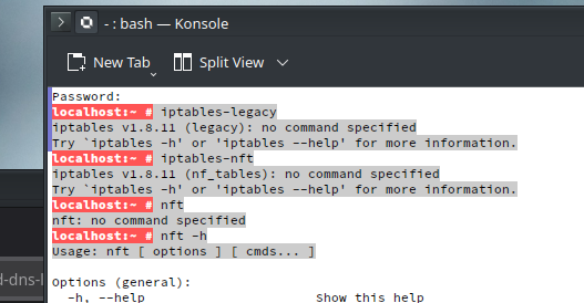

I'm a bit confused that a very important UI message in 0:17 is nowhere to be seen in the logs.. but that's not on you. It says There is no available or enabled Network Lock mode, sorry, indicating that neither of these tools could be found on your system:
  • iptables-legacy
  • iptables-nft
  • nft
Could you please check whether any of those is callable from a (privileged) shell? If not, I think simply installing nft (or nftables) with your package manager may fix everything for you, even the DNS leak.
  • iptables-legacy
  • iptables-nft
  • nft
it seems to return those using "terminal - super user mode"
And in one of the tests, I had to manually disable NetLock because it would lock up the app and prevent me from connecting, as shown at 0:17.
Keeping NetLock enabled in this situation prevents the software from connecting. So I ran two tests: one with it on and one without it.
This is evident in both the one log and the video. It does not allow me to connect, therefore I ran the second test without it.
Or that any "Network Lock" mode is disabled by setting "Network Lock" box to "None" in "Preferences" > "Network Lock" window (default: "Automatic"), as it is indeed the case according to the system report (important option not at default: netlock.connection false) and considering that the user's system does have nft and iptables-* installed. Splitting the different cases with different messages and logging them will be suggested to devs.
