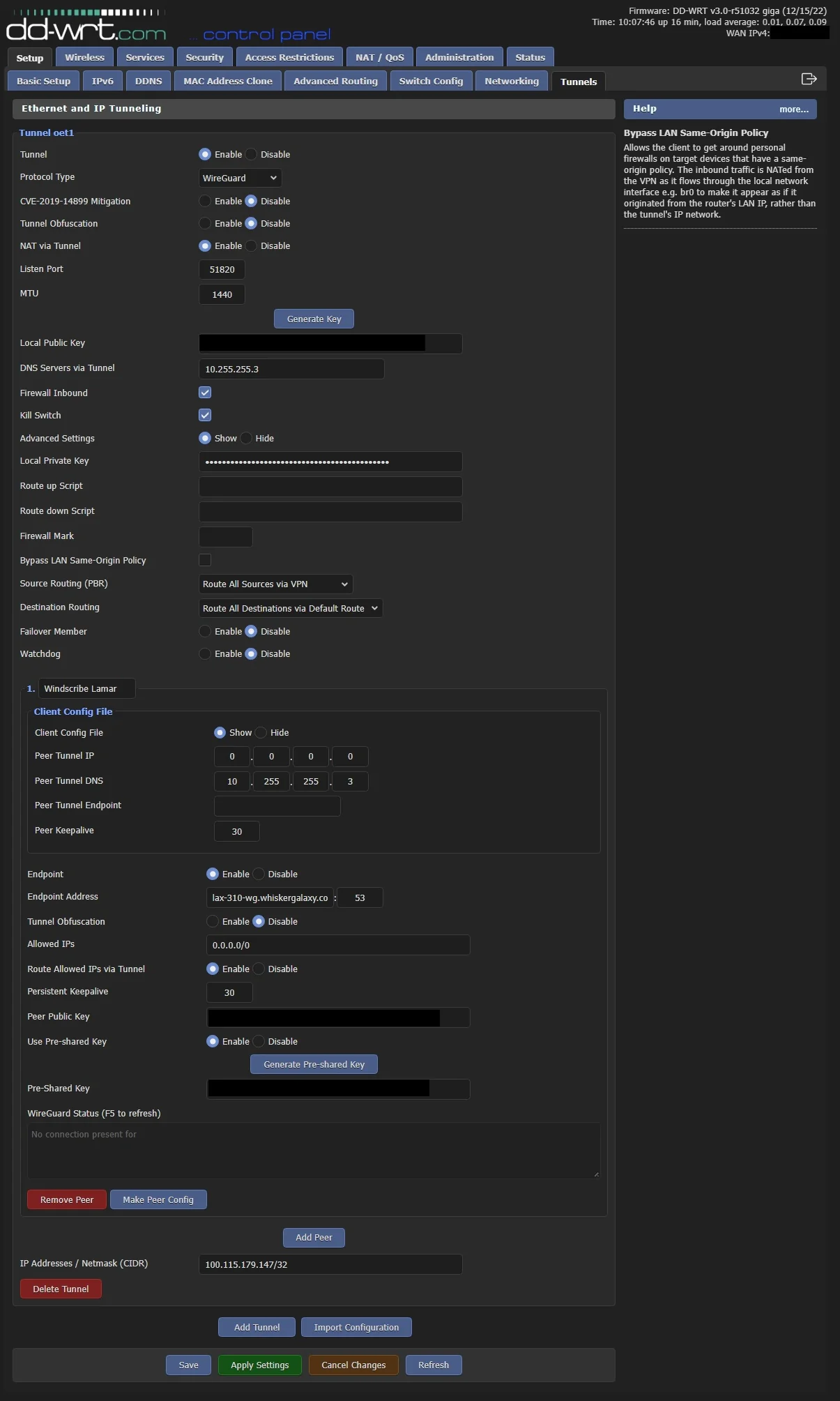

Does AIRVPN support or intend to support Wireguard Scramble/Obfuscation, I'm using DDWRT and it has an option to obfuscation using a password/secret key, but it must be enabled on the server side also. Currently, Wireguard is completely blocked in Egypt.

preshared key is not for obfuscation, the tunnel obfuscation is another new option in DDWRT to scramble the connection using a secret key and pass the DPI (see attached)
