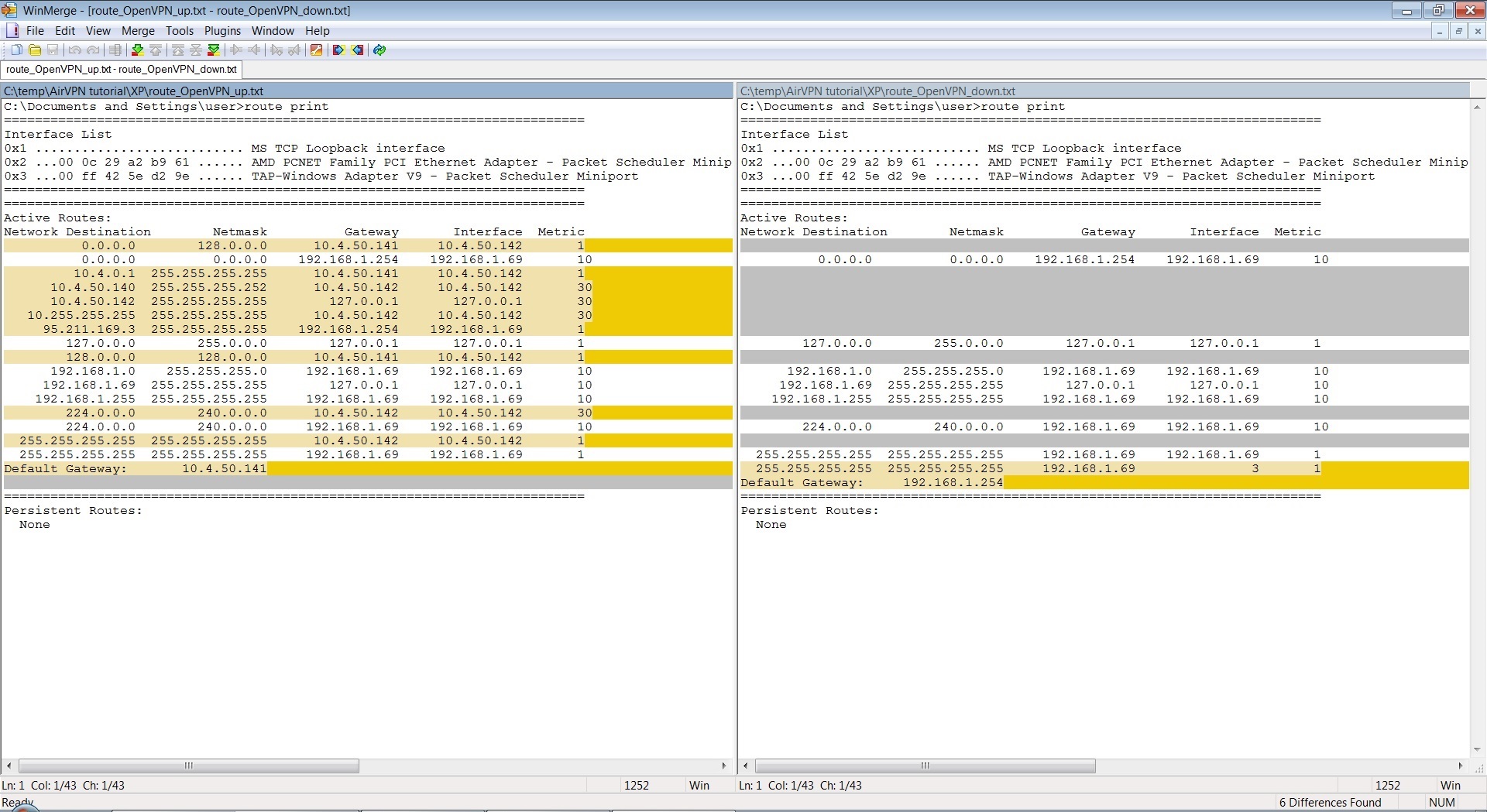

Compare these results to what we had before the install. In the sample above, a new IP interface called "Local Area Connection 4" has been created by the install.

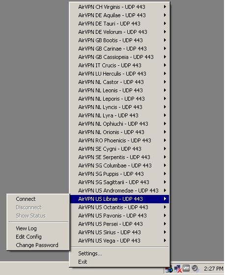

Configuring OpenVPN to Access Servers
Then to get the VPN set up initially, at AirVPN go to "Client Area/Config Generator". The page says "OpenVPN Configuration Generator ". Press the "Invert" button to select all of the servers (why not?). Then select "UDP" under "Protocol" and then "443" under "Port". Agree to the terms of service and press the "Generate" button.
This will have created a file called "air.zip". Save it somewhere. Unzip this into a folder. Let's say it is called "AirVPN". It will contain files like this:

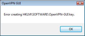

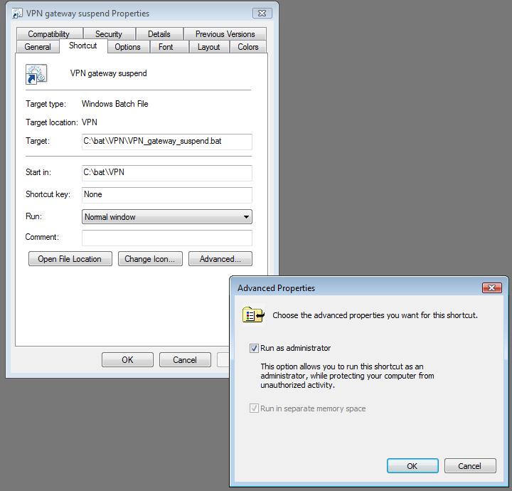

Start up the OpenVPN GUI. On Vista or Windows 7 it will require administrator privilege. The following error messages may be symptom if it is not running privileged:
Either always right-mouse click and "Run as administrator", or alter the desktop icon for the OpenVPN GUI to always run as administrator:
The icon for the OpenVPN GUI will be in the system tray. Right-mouse click on it and select a server. On Windows XP the menu looks like this:
There is a page at AirVPN that gives info on how loaded each server is which cane be helpful when selecting a server to use. When the window showing the log closes and the message saying the VPN is up comes up.

Comparison of Routing Table with VPN Up Versus Down

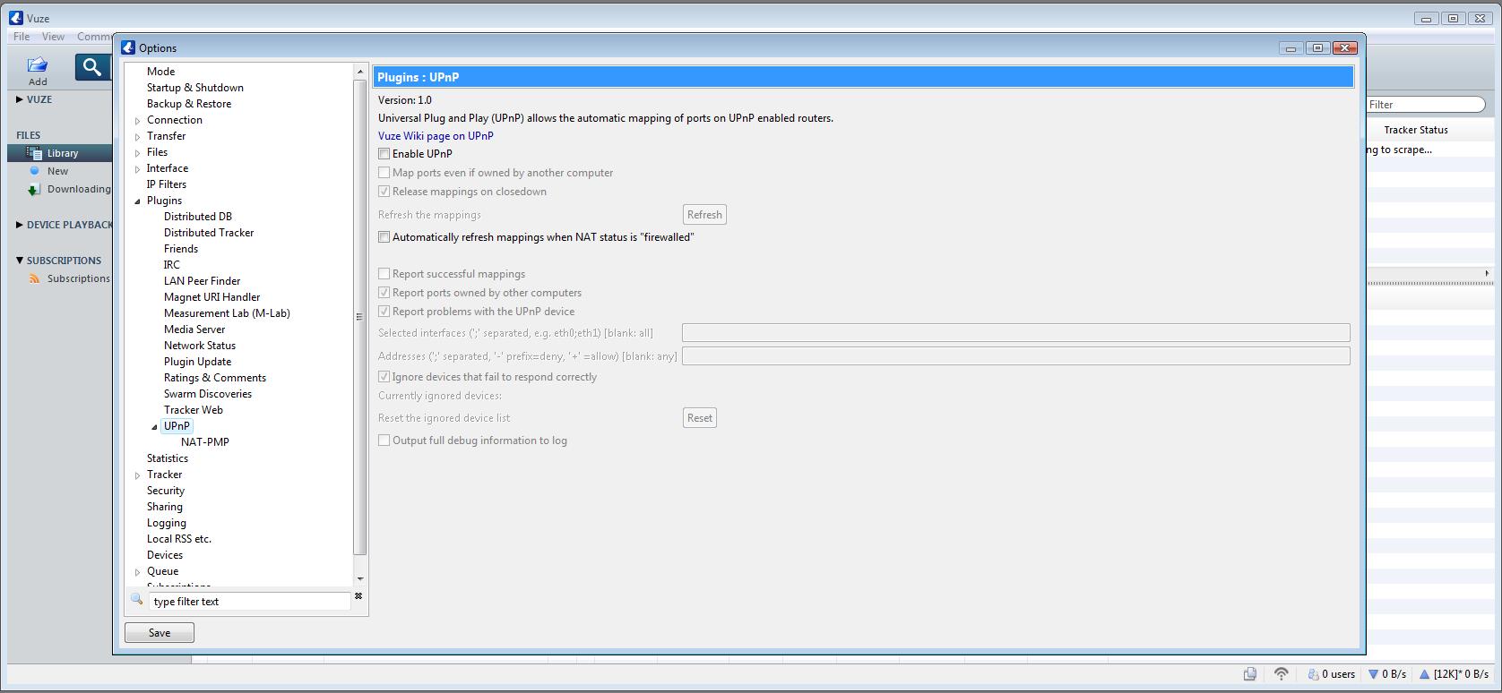

For Vuze do "Tools/Options", then "Connections" and paste in (or type) the port number AirVPN generated for you. The click "Save".
Also for Vuze, to turn off UPnP and NAT-PMP use "Tools/Options/Plugins/UPnP" and "Tools/Options/Plugins/UPnP/NAT-PMP":

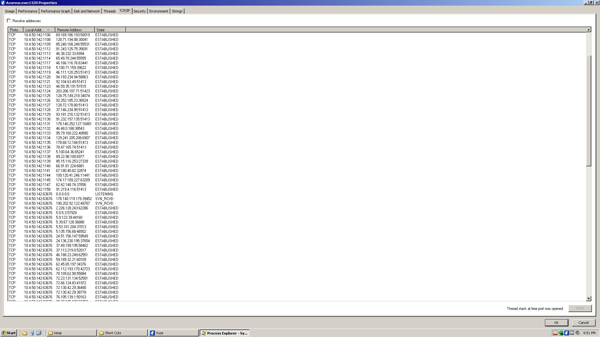

Process Explorer
But there is a more general and powerful way to check what is happening with a torrent clients IP connections. There is a useful tool that Microsoft provides - "Process Explorer":
http://technet.microsoft.com/en-ca/sysinternals/bb896653.aspx
With it you can see all of the network connections a program is making. Once it is installed, start it and in the process tree that gets shown locate "uTorrent.exe" or "Azureus.exe" under "explorer.exe". Right-mouse click on it and select "Properties..."`. Then select the "TCP/IP" tab. In that uncheck the "Resolve addresses" check box. If you see connections on the port that you set up as the incoming port, that is another indication that you are receiving incoming connections.
Using Process Explorer you will also be able to see if any connections are being made on the native interface rather than the VPN interface (as they should).
This is an example of what you can see with Process Explorer:
In the example above, Vuze is listening for connections on port 63676, so the "ESTABLISHED" connections to that port are from incoming connections.
It can be helpful to sort the items in this display in various orders by clicking on the column headers. The possible states are described here:
http://support.microsoft.com/kb/137984
This is a summary taken from the link above:

Now look at the screen shot above labelled "Comparison of Routing Table with VPN Up Versus Down".
The extra lines when the VPN is up were added by the OpenVPN client. Note these two extra lines in particular:
Network Destination        Netmask          Gateway       Interface  Metric
         0.0.0.0        128.0.0.0      10.4.50.141     10.4.50.142       1
       128.0.0.0        128.0.0.0      10.4.50.141     10.4.50.142       1
Default Gateway:       10.4.50.141
These entries with "128.0.0.0" prevent the "0.0.0.0" from ever being used, because one of these will match any address, and they are more specific (one 1 bit on the left of the Netmask rather than no bits at all). This makes the VPN gateway (10.4.50.141) the new "default gateway".
The other additional entries serve various purposes which are not relevant to our discussion below.

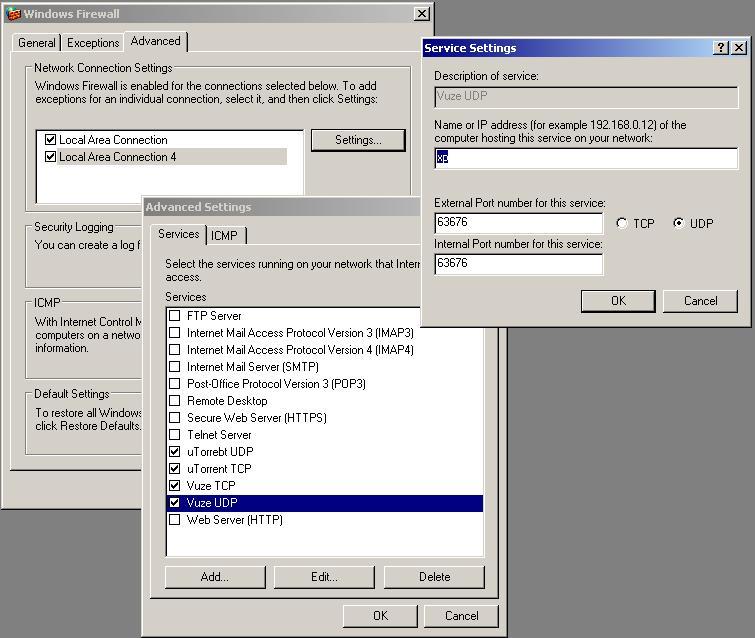

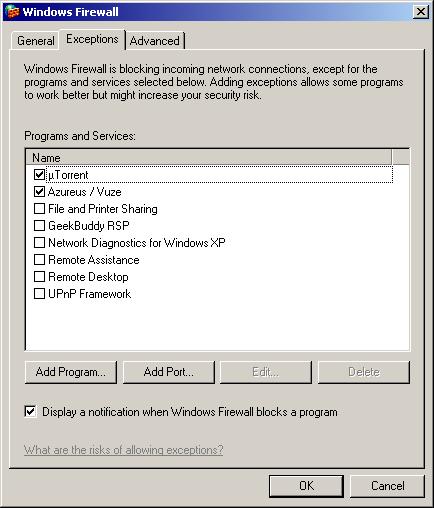

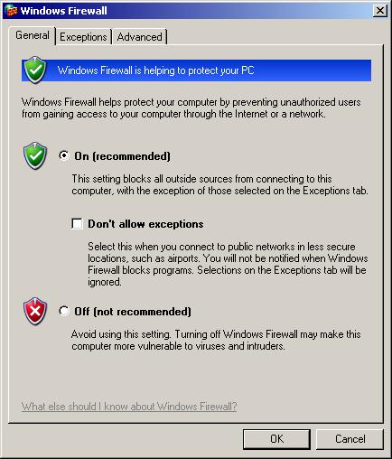

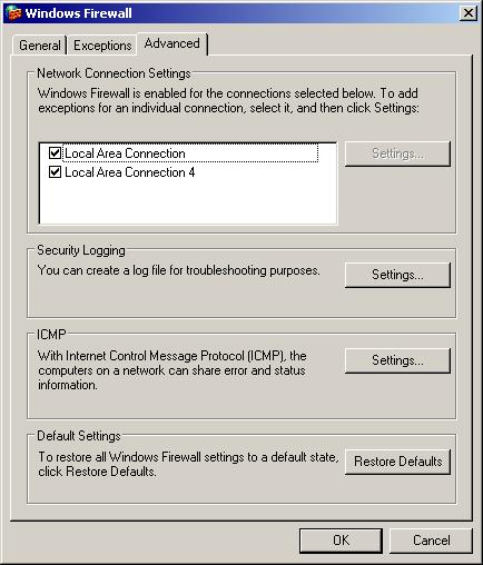

Set Up for Windows XP Firewall
First I will discuss the firewall. It does not seem to be possible to fully block all torrent traffic from the native interface using just the limited firewall that came with XP.
Although you can block incoming connections to some extent, you cannot block outgoing connections at all. And registering your IP address against torrent hashes on a tracker or by DHT is already bad enough for IP address trolls to see you. And if they register themselves on a tracker as having a torrent you want, you may connect to them (even worse). You could also be given their IP address as a source by peer exchange even if you strip things to DHT only.
With some other firewall that works on XP you may still be able to do this. There may be information on the AirVPN forum.
If you have a router, you may not have had Windows firewall enabled, relying on your router to provide the firewall. However you should have Windows firewall enabled at least for the VPN interface, with an exception for your torrent client. The following screen shots illustrate how to do this:
This will allow incoming connections for torrent clients from the native interface too. But you should be able to configure your router so that no incoming connections are forwarded from the internet to your PC. You will have to poke around in its GUI/HTTP interface. Besides turning off any explicit port forwarding in your router, you need to consider UPnP:
https://en.wikipedia.org/wiki/Universal_Plug_and_Play
UPnP support in the router allows a program running on your PC to tell your router to set up port forwarding. Most routers now a days support this. It seems that because of this many people do not realize that incoming connections are being forwarded to their torrent client. The thing is, malicious programs can do this too!
So you may want to go further and disable UPnP in your router. However you may be using some other program that needs it. With UPnP off (and no explicit port forwarding rules in the router), you can be sure that no incoming connections can come in by the native interface.
If you do want to block incoming torrent connections only on the native interface, then do not enable the exceptions for the clients on the "Exceptions" tab as shown above, but instead go to "Advanced Settings" from the "Advanced" tab and provide exception rules only for the VPN interface, as shown below:
Using this approach, you have to define the rules based on the ports rather than the programs, and you will need a TCP and a UDP rule for each port.

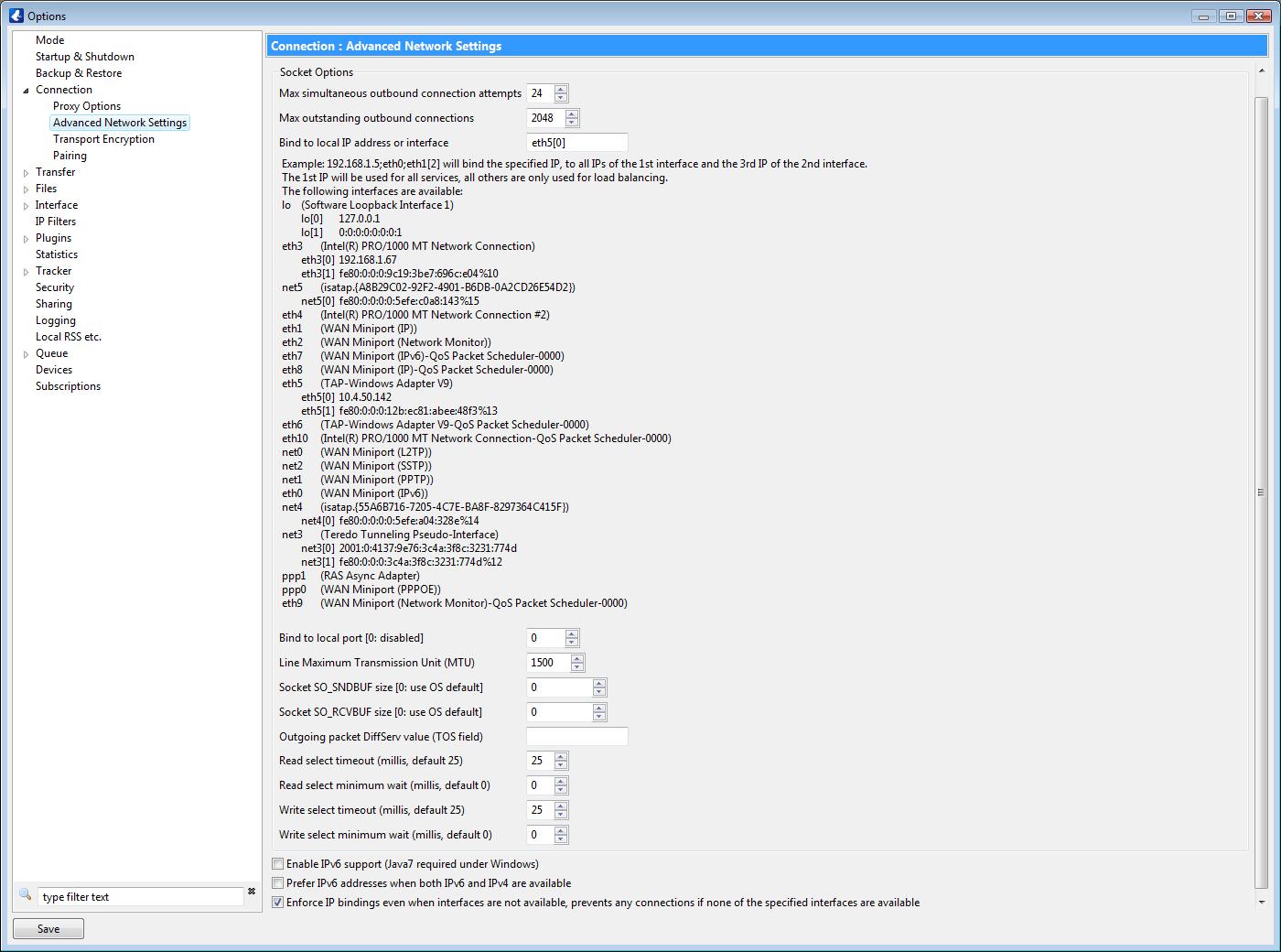

But there is a saving grace. Fortunately Vuze has an option that prevents it using the default interface if it is configured to use a specific interface. I use this on Windows 7 too, even though it does not appear to be necessary.

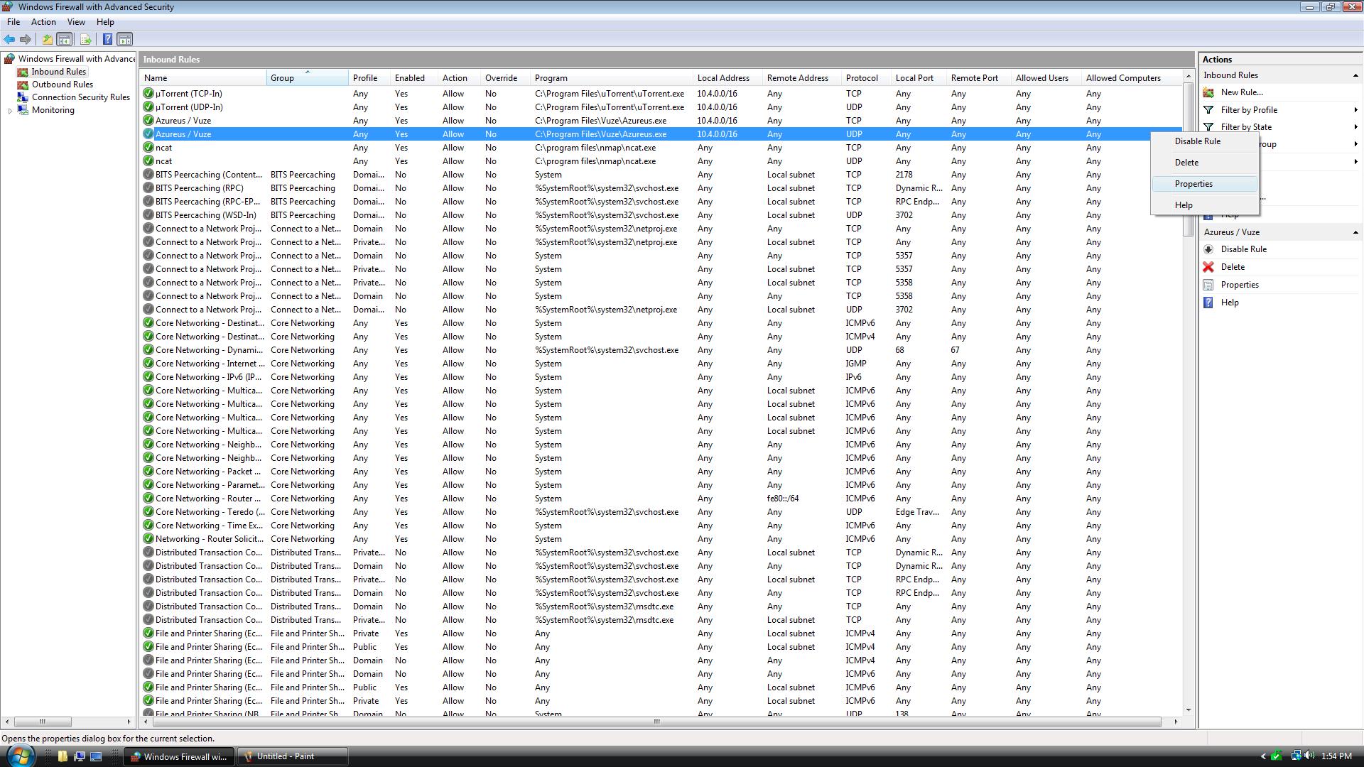

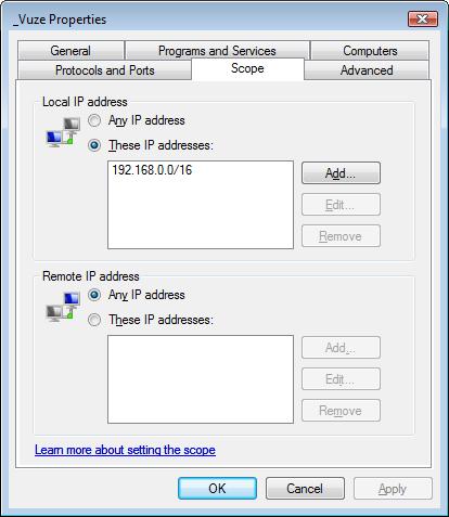

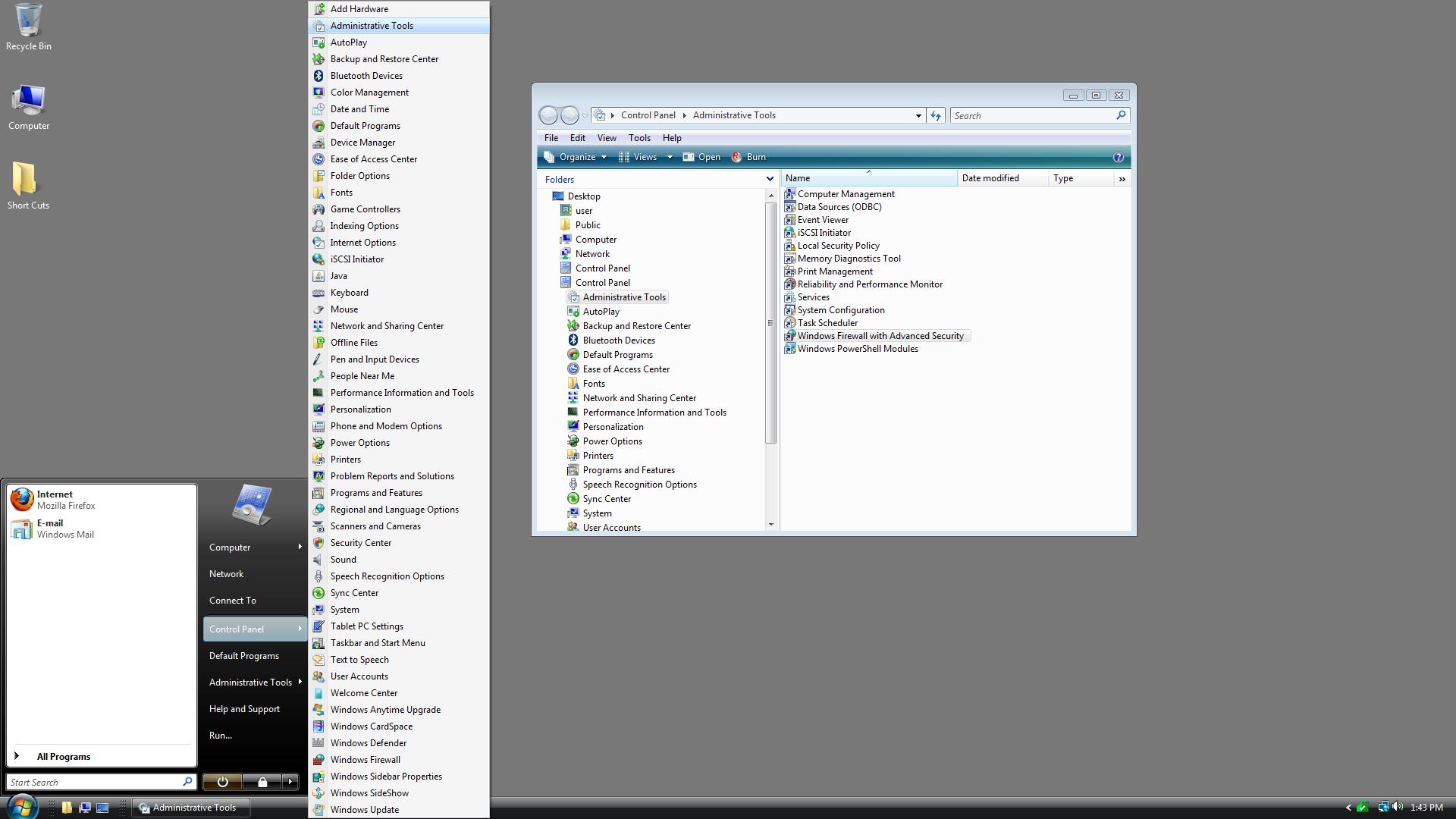

Set Up for Windows Firewall with Advanced Security

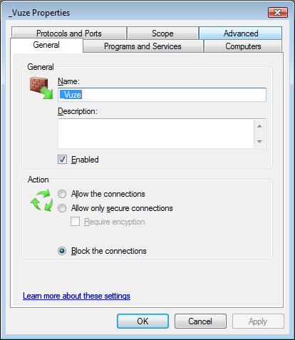

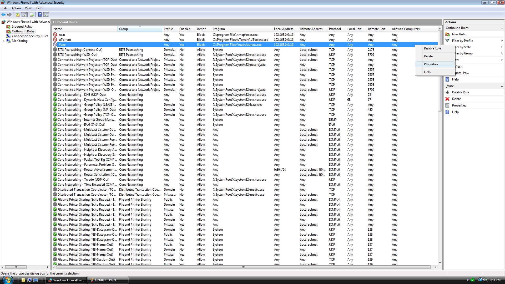

To set up the blocking of both incoming and outgoing connections in the way we need, you have to use "Windows Firewall with Advanced Security", which is separate from "Windows Firewall" in the Windows Start menu. You have to first get into "Administrative Tools". The following screen shot shows how to get into "Windows Firewall with Advanced Security":
Once you are into ""Windows Firewall with Advanced Security"" you can configure rules for both incoming and outgoing connections at a level of detail much greater than you could for Windows XP. In order to do this we will need to determine an appropriate subnet definition for the native interface and the VPN interface. This can be obtained from examining output from the "ipconfig /all" and "route print" commands:

For the firewall rules, we need to use the CIDR subnet ("prefix/length") notation:
http://en.wikipedia.org/wiki/CIDR_notation#CIDR_notation
We will go with "10.4.0.0/16" as a subnet definition containing the VPN address and with "192.168.0.0/16" as a subnet definition containing our native interface. We need these two subnet definitions to not overlap, and to be big enough that they will not need to change if the address given to us by the VPN DHCP server or our router DHCP server changes. A prefix length of 16 should be plenty for this.
I will explain the rationale for the firewall rules I set up after some screen shots that give the jist of how to use the firewall set up GUI.
The following screen shots show the summary window:
Rules for Incoming Connections
Rules for Outgoing Connections
The following screen shots illustrate how to set the properties of firewall rules:
Specifying the Properties for a Firewall Rule
Installing (or perhaps running the first time) uTorrent will have created Inbound rules named "Torrent (TCP-In)" and "Torrent (UDP-In)". Installing (or perhaps running the first time) Vuze will have create a rule named "Azureus / Vuze" for each of TCP and UDP. We want to change these so that they allow incoming connections only from the VPN. In the screen shot above for Incoming connections you will see that the "Local IP address" property has been set to "10.4.0.0/16". Although I do not recall changing anything else, make whatever other changes you need to ensure that the rules you create are as in the example above. You could if you prefer disable the original rules and create new ones.
The uTorrent and Vuze installations do not create any Outbound rules. So I have created a rule for uTorrent ("_uTorrent") and for Vuze ("_Vuze"). We want these rules to block outgoing traffic over the native interface from our torrent clients. We need these rules to be "blocking" rules, applying to all profiles and all protocols, and with that the "Local IP address" property has been set to "192.168.0.0/16". Make whatever other changes you need to ensure that the rules you create are as in the example above.
Set Up for Torrent Clients
Next we set up the torrent clients to use only the VPN interface. This will give additional assurance that torrent traffic does not go out over the native interface, and also allow us to make the changes to the routing table that will cause the VPN interface to be used only for torrent traffic.
The following screen shot illustrates setting the IP interface for uTorrent:
Setting IP Interface for uTorrent
From the menu in uTorrent select "Options/Preferences" and then select "Advanced". You need to set the "net.bind.ip" and "net.outgoing.ip" to the IP address of the VPN interface. Unfortunately for uTorrent one has to specify the IP address, unlike Vuze (see below).
So long as I continue to use the same AiirVPN server, since my DHCP license is for a year, I do not need to change the uTorrent configuration. If I wish to change the AirVPN server, I have to change IP address uTorrent uses.
At the time of writing, AirVPN does not allow one to have a fixed local IP address for
the VPN interface, otherwise this could be avoided.
The following screen shot illustrates setting the IP interface for Vuze:
Setting IP Interface for Vuze
From the menu in Vuze select "Options" and then select "Connection/Advanced Network Settings". First ensure that the check box labelled "Enforce IP bindings even when interfaces are not available, ..." (at the bottom of the page) is enabled. Next fill in the text box labelled "Bind to local IP address or interface". You could fill in the actual IP address of the VPN interface as we did for uTorrent. But it is better to scan the list of interfaces further down the page for the one for the VPN interface. In the sample screen shot you will see that the VPN address "10.4.50.142" goes with the interface "eth5[0]". So I have copied and pasted that into the text box instead. By using the interface name rather than the IP address, I avoid having to change the Vuze set up if the address of my VPN interface changes (when I switch OpenVPN servers for example).
Routing Table Changes to Restore Native Gateway
The final step in this set up is to add some additional routing table entries to restore the native gateway as the default gateway. Recall (see the discussion above) that the OpenVPN client added two routing table entries with a subnet prefix length of 1 bit (net mask 128.0.0.0) in order to override the original routing table entry that made the native interface the default gateway. That original routing table entry (just 1 entry) had a subnet prefix length of 0 bits (net mask 0.0.0.0). Because the subnet prefix length of the routing table entries the VPN client made is longer, and the two entries together cover the full IP address space, these two new entries had the effect of overriding the original default gateway.
One might think then that we just need to delete the two entries with net mask "128.0.0.0". And indeed, if we were not using Windows, this would probably work! But I have found that with these entries removed, Windows does not allow the torrent clients to bind to the VPN interface, which they were configured above to use. But there is another possibility, which I have found does work.
We will do what the VPN client did - add more routing table entries. Our entries will have a subnet prefix length of 2 bits (new mask 192.0.0.0). In order cover the full IP address space we need 4 entries (see the pattern?). To this end, create two ".bat" files. Files ending in .bat are expected by Windows to contain "scripts" that run the same commands that you can run at the Windows Command Prompt. Create two files as follows -
"VPN_gateway_suspend.bat" containing:
@set GATEWAY=192.168.1.254
route add 0.0.0.0 mask 192.0.0.0 %GATEWAY%
route add 64.0.0.0 mask 192.0.0.0 %GATEWAY%
route add 128.0.0.0 mask 192.0.0.0 %GATEWAY%
route add 192.0.0.0 mask 192.0.0.0 %GATEWAY%
@pause
"VPN_gateway_restore.bat" containing:
route delete 0.0.0.0 mask 192.0.0.0 %GATEWAY%
route delete 64.0.0.0 mask 192.0.0.0 %GATEWAY%
route delete 128.0.0.0 mask 192.0.0.0 %GATEWAY%
route delete 192.0.0.0 mask 192.0.0.0 %GATEWAY%
@pause
I put my files into the folder "C:\bat\VPN". The route commands to add and delete entries require administrator privilege. So to run the .bat files directly you have to right mouse-click on them and select "Run as administrator". As a convenience, I create short cuts to these .bat files and set "Run as administrator" in their "Advanced Properties":
To be sure these scripts and short cuts are working for you, use the "route print" command in a Windows Command Prompt window.

EDIT 2:
I should have mentioned that the firewall set up would have to be addressed quite differently for Linux since IPTABLES does not allow the program instance making the connection to be specified in a rule (unless some dramatic changes have occured since I last did this sort of thing on Linux).
So you would have to block incoming connections to the ports on which your clients are listening instead.
To do the blocking for outgoing connections, you would want to figure the clients (possible for Vuze and uTorrent) to use a fixed port for outgoing traffic, and then block outgoing traffic for those ports.

Hey do we need to disable upnp on the router side, and also I am gettiung DNS leaks on the dns leak test... Please advise
Hey do we need to disable upnp on the router side, ...
I do. But it would probably be enough to ensure the torrent client is set up not to use it. I believe there may be some programs (Games? I am not a gamer.), that will not work without UPnP support in the router.
... and also I am gettiung DNS leaks on the dns leak test... Please advise

I will assume you have used the same names as in the guide.
After you start the VPN, you must run the one called "VPN_gateway_suspend.bat" after you start the VPN, in order to get back to using the "real" interface for everything besides torrents.
If at some point you want to use the VPN for browsing for a while, then run "VPN_gateway_restore.bat". When you want to go back to using the real interface again run "VPN_gateway_suspend.bat".
After you stop the VPN , you can run "VPN_gateway_restore.bat" to remove the double definition of the real gateway from the routing table, to get back to how things were before you started. You could also run "VPN_gateway_restore.bat" just before you stop the VPN instead. Or in fact you could just leave the double definition of the real gateway in the routing table. It should do no harm.
Update:
If you do not want to have to run the "VPN_gateway_restore.bat" script by hand after you start the VPN, then assuming that the script is in "C:\bat\VPN\VPN_gateway_restore.bat" (as in the guide) then you could add some lines to your OpenVPN config files by ticking "Advanced Mode" and entering the lines under "Custom directives:" on the AirVPN "Configuration Generator" page. The lines to enter are:
script-security 2
up 'C:\\bat\\VPN\\VPN_gateway_suspend.bat'
This will just leave the double definition of the gateway in place when you stop the VPN, which as I said above should do no harm. If you want the double definition removed then the lines you add should be:
script-security 2
down 'C:\\bat\\VPN\\VPN_gateway_restore.bat'
Update 2:
It turns out that the AirVPN Configuration Generator does not handle the "\" characters correctly when they are used in "Custom directives:".
So instead you will have to add these lines instead:
script-security 2
up 'VPN_gateway_suspend.bat'
down 'VPN_gateway_restore.bat'
And then copy the scripts you created in with the "*.ovpn" files.
I had not realized this because I have my own methods for customizing configuration files.
Not having too much luck here.  My NAS was running WHS v1 for over 4 years and I had it set so that everything went through the VPN, which was overkill.  I upgraded it to Windows Server 2012 R2 last weekend, and would like to use the VPN only for torrenting on it (I do my browsing, emailing etc on an iMac).
First thing I noticed is that checking the status in the Forwarded ports section here gives me a greyish/black dot saying it's unreachable.  Connection timed out.
Process Explorer was showing a lot of other addresses, instead of just the VPN one, which is odd.
I think I need to start the process from scratch, but I'm kind of at a loss about the forwarded port not working. That was working fine before I upgraded, so it's an OS setup thing and most likely a PEBKAC issue, but if anyone has a suggestion, I'm all ears (or, well, eyes... )
Hey do we need to disable upnp on the router side, and also I am getting DNS leaks on the dns leak test... Please advise
Your post seems to be identical to the one by hakrins earlier in this thread. And I responded to it in an earlier post in this thread:
https://airvpn.org/topic/9491-guide-to-setting-up-vpn-just-for-torrenting-on-windows/?do=findComment&comment=12757
Besides discussing DNS, I made a brief comment about UPnP there too. I disable it.
I am not aware of any programs I use that actually tries to use router functionality to discover the real IP address, but apparently this is possible in principle not only by using UPnP but also "SIP ALG":
https://airvpn.org/topic/13466-webrtc-used-to-reveal-real-ip-address/?do=findComment&comment=24629
So I have now disabled that in my router too, while it is "top of mind".

So I followed this guide and I don't really understand what is going on.  All it has done is make it so my uTorrent only works when connected to a specific AirVPN server.  All of my web browsing and such still goes through the VPN though.  If I disconnect from AirVPN my torrents stop.  I reconnect and they start again, but now Whatsmyip.org shows that I'm connected to the VPN.
You have to do the final step where you add the routing table entries with a "Netmask" of 192.0.0.0.
Except instead of 192.168.1.254 it should be whatever your default gateway is.
You either missed this step out, or made some error. Do "route print" in a command window. There must be routing table entries with a "Netmask" of "192.0.0.0" that match the original routing table entry with a mask of "0.0.0.0" (i.e. same "Gateway").
