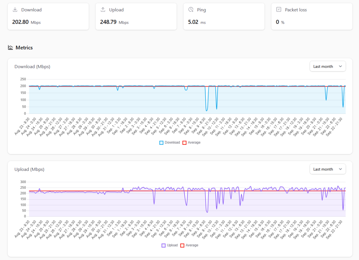

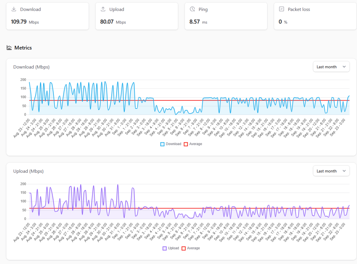

To locate the issue, I set up two separate Speedtest trackers in Docker over the past weeks:
  1. Direct Internet (bypassing VPN): Consistently holds 202 Mbps (see attached graph).
  2. Via AirVPN (Gluetun with WireGuard): Flatlines strictly at ~100 Mbps since early September (see attached graph).
