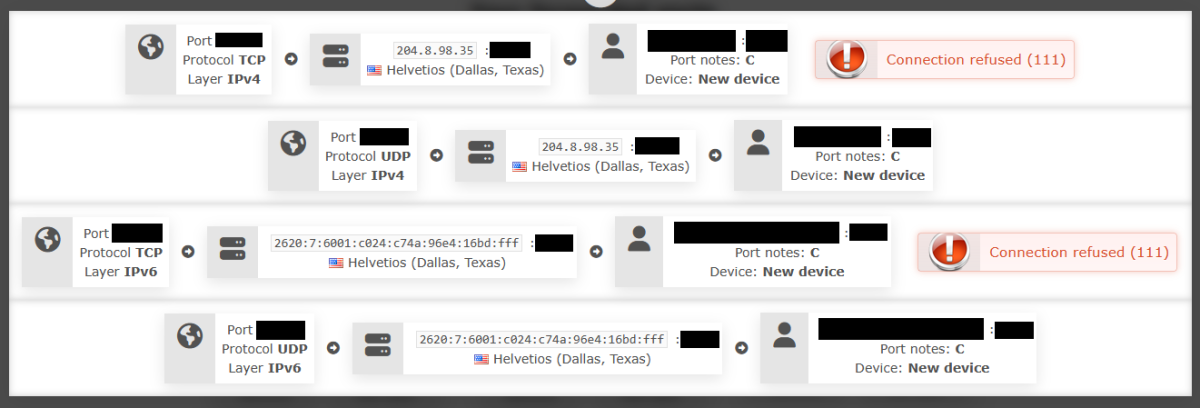

A few years ago I had forwarded some ports through AirVPN's site. It worked just fine and so I left it alone all of this time later.
For some reason now, it doesn't seem to be actually forwarding them. I'm using OpenBSD and am connected to AirVPN's servers through openvpn. Port checks fail, connections time out, but the servers I'm running locally have indeed occupied those ports (I can access via its local IP). The firewall (pf) has those ports allowed over tun0. Is there something I'm missing or doing wrong, or is there a tiny chance Helvetios (server in question) has some issues?
FWIW I tried reconnecting to AirVPN multiple times in the hopes of reaching a different server, but every single time it connected to Helvetios.
Thank you in advance if you can help shed some light on this.
In reality your current error message is connection refused (111). It means in general that the packets were forwarded and reached the destination (your node), but it actively reset the connection via TCP RST. We have also checked in real time on the server you mention and packets are properly forwarded from the correct ports to your VPN IP address:port.

Hi, thank you for the reply.
In the AirVPN web interface, I only see that for TCP connections, but never for any UDP ones (regardless of that, though, none of them work unfortunately). Here's an example of one of my forwarded ports that uses both:

On 6/29/2026 at 6:03 AM, Staff said:
Finally, a simultaneous packet capture while reproducing the issue:
$ doas tcpdump -ni tun0 tcp port XXXXX
tcpdump: listening on tun0, link-type LOOP
^C
829 packets received by filter
0 packets dropped by kernel
I started the packet capture for XXXXX, then tried connecting to the server externally (failed), then SIGINTed the capture process. Strangely, no packets were dropped.
YYYYY and ZZZZZ (these should only be accessible externally) both show a bunch of traffic when connecting externally, which seems work significantly more reliably. External port checks on those also show traffic upon each check (but still claim to be closed).
Thank you
