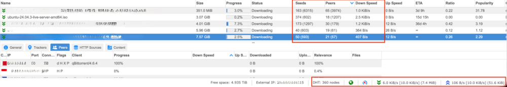

I’m experiencing very low torrent speeds (max 10KiB/s) on my NL servers, despite everything being correctly configured. This is unusual because until recently, I was getting high speeds on the same setup.

  • qBittorrent: multiple torrents running with hundreds to thousands of seeds, download stuck at total max 10 KiB/s max, barely any improvement with multiple torrents.
    Even torrents with many seeds run at e few B/s!

On 2/2/2026 at 3:12 PM, Peter Laanstra said:
You actually have set a speed limit of 10 kb/s, might have been by accident of clicking that little speedometer icon
36 minutes ago, AG999 said:
On 2/2/2026 at 12:12 PM, Peter Laanstra said:
OMG that's right @ag999. LMAO! Just tested it and was the same. Now I know.
I did not know this was a feature to click on that speedometer. 🙈
Hope it helps others...
