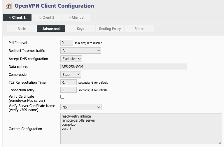

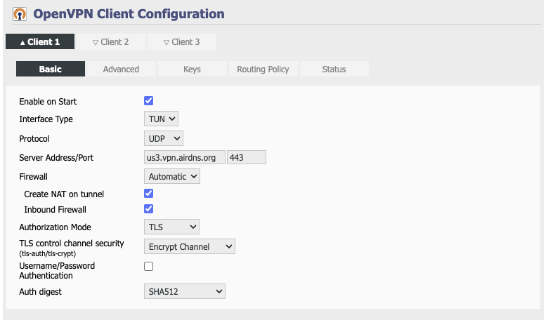

I'm trying to setup AirVPN on a Router running Fresh Tomato. It seems the instructions I found here are a little bit outdated (2015) and the options differ a little bit.
Here is where I'm at right now and I was hoping for some tip or hints for the correct setup:
1035327862_Screenshot2025-09-06at3_43_37PM.png.d6865caa4d716343f8c6ebf572d109fd.png322114173_Screenshot2025-09-06at3_43_12PM.png.9bbdc8f45c255580b8f17461c660ffb6.png
There's an option for
remote-cert-tls server
right above custom options.  So it doesn't need to be in custom options.
I'd add to custom options:
persist-key
persist-tun
nobind
Finally, AirVPN doesn't use compression so switch off that compression option (currently it's on stub) and also remove
comp-lzo
from custom options.

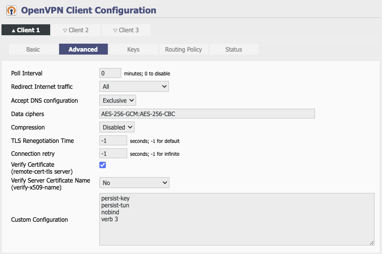

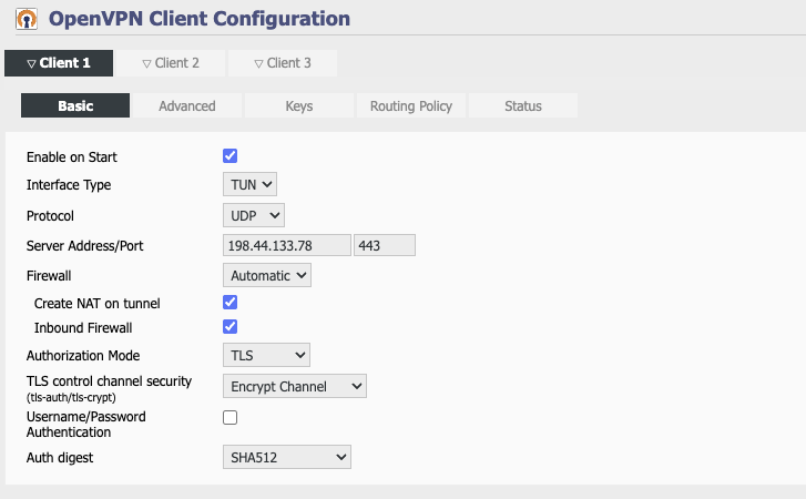

Here is my working Open VPN config on a Netgear R7000 with Fresh Tomato:
