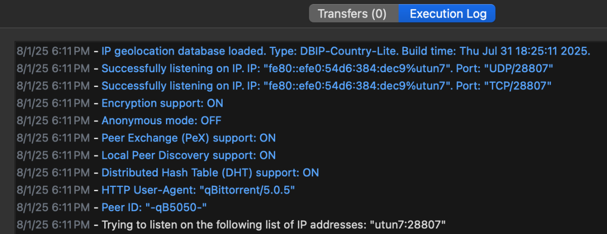

Yes it was restarted each time. attached is the qB execution log. even when i have it on "any interface" all of them say successful, but when i try to connect with eddie it trys to connect then immediately disconnects and loops until cancelled. thanks for your help.
Huh? How does Eddie play into any of this? The problem I understood was "port is unreachable despite having been forwarded", but now we're on "Eddie cannot connect"? Please make up your mind about what exactly you want the community's help with, and stick to that problem. Any other problem should be discussed in another thread.

To clarify the matter for reader's comfort, there was only one problem: Eddie refusing to start apps not owned by root. The message "No port(s) open" is correct, as it is thrown when the device linked to the port(s) is not connected (or when the user disables the port forwarding for that port on the port control panel).
