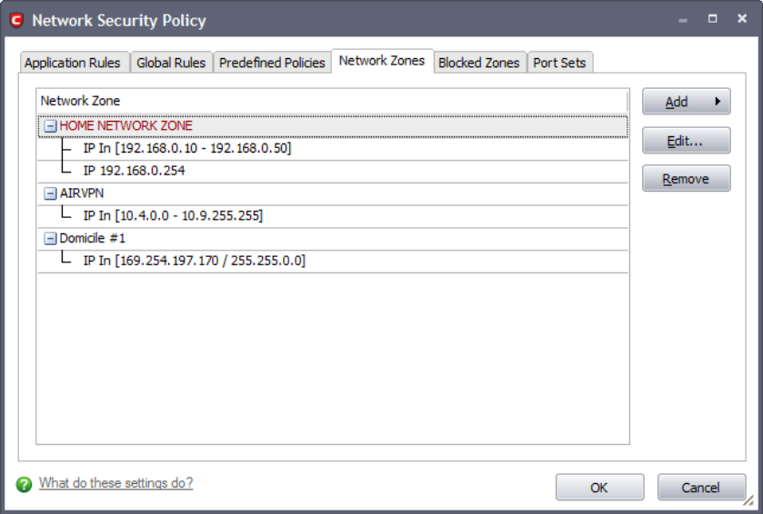

I've also change my network zones (was wrong to me):
Posted Image

Ok, situation now is much clearer.
The rule:
Allow TCP or UDP In/Out From MAC Any To IP 192.168.0.254 Where Source Port Is Any And Destination Port Is Any
will allow at least DNS leaks, please delete it.
The rule:
Block And Log TCP or UDP In/Out From MAC Any To MAC Any Where Source Port Is Any And Destination Port Is Any
is sub-optimal because prevents only TCP or UDP leaks, please modify it into:
Block And Log IP In/Out From MAC Any To MAC Any Where Protocol Is Any (this will expand the total block to layer 3).
We're looking forward to hearing from you.
