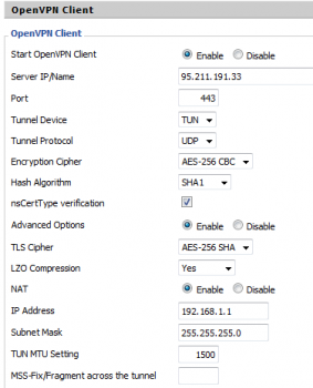

I configured my router (Netgear WNR3500L) with the help of https://airvpn.org/ddwrt and can only connect to my ISP. Here is my log if someone can figure it out.
Serverlog Clientlog 20120910 13:11:24 I OpenVPN 2.2.1 mipsel-linux [sSL] [LZO2] built on Jul 31 2012
Can you please send us information about your DD-WRT OpenVPN setup (if you use the DD-WRT web interface, screenshots are just fine)?
@gpiper

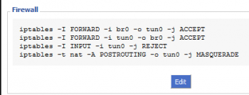

The attached screenshot show a correct configuration. Can you please check iptables rules and make sure that certificates and key have been properly copied and pasted? Can you also send us the OpenVPN logs?

I've connected with ssh to router and it seems that OpenVPN creates this client configuration file:
ca /tmp/openvpncl/ca.crt
cert /tmp/openvpncl/client.crt
key /tmp/openvpncl/client.key
management 127.0.0.1 5001
management-log-cache 50
verb 4
mute 5
log-append /var/log/openvpncl
writepid /var/run/openvpncl.pid
client
resolv-retry infinite
nobind
persist-key
persist-tun
script-security 2
mtu-disc yes
dev tun1
proto udp
cipher aes-256-cbc
auth sha1
remote 69.163.36.66 443
tls-client
tun-mtu 1500
comp-lzo yes
ns-cert-type server
fast-io
tls-cipher AES256-SHA
where it's using "tun1" instead of "tun0" for interface.
According to this I've modified the command sripts to
startup
/usr/sbin/openvpn --mktun --dev tun1
firewall
iptables -I FORWARD -i br0 -o tun1 -j ACCEPT
iptables -I FORWARD -i tun1 -o br0 -j ACCEPT
iptables -I INPUT -i tun1 -j REJECT
iptables -t nat -A POSTROUTING -o tun1 -j MASQUERADE
NOTE: My home setup has two routers: one from my ISP provider(192.168.1.1) and LINKSYS E4200(192.168.15.1) sitting behind ISP router.
WAN of LINKSYS router is connected to LAN of the ISP router. My laptop connected with cable to LINKSYS router can access the internet.
I've been trying different startup scripts but nothing seems to work.I'm trying to connect to Vega server(DNS 10.4.0.1) using UDP on 443 port.
Please help.

@gpiper
Kind regards[/quot]
I recopied the certificates and key plus the firewall iptables from https://airvpn.org/ddwrt
I also tried a different server (Leonis)...no luck. Here is the OpenVPN log:
Please help.
Thanks

Hi,
I've modified OpenVPN configuration to connect to the same server(Vega) but this time using TCP protocol and Port 80.
OpenVPN client keeps trying to reconnect to the server with no real success. The state bar shows "RECONNECTING".
When using UDP on port 443 the state bar showed "AUTH".
I've attached the log file and the screen shot with the new configuration for OpenVPN. I've also disabled firewall, so we can focus first on connection.
Thanks
vpnlogs_2.zip

Hi,
Thanks

After reading zdrifter's post I found that I use tun1 interface. I added the new iptables (except for the last line) in the firewall and saved. I still have a dns leak confirmed with http://www.dnsleaktest.com
If the leak is confirmed, you might like to read the zdrifter post about that and more (it will prevent any leak):
https://airvpn.org/index.php?option=com_kunena&func=view&catid=3&id=2377&Itemid=142#2377

Ok, this new screenshot shows what you say. We should examine the iptables rules.
They are not visible on the screenshot which is pertaining to the DD-WRT web interface. You should watch at the DNS servers displayed in the leak test site. Anyway, does the dns leak site display your ISP DNS? If so, can you please post your complete iptables rules list?
Sorry, I tried to upload more than 1 screenshot.
Desktop.zip
Ok, now we have all the information we need.
A rule is missing:
iptables -I OUTPUT -o ! --dst a.b.c.d -j DROP # if destination for outgoing packet on is NOT a.b.c.d, drop the packet, so that nothing leaks if VPN disconnects
# the above line can be duplicated for as many Air servers as you wish to connect to, just insert the appropriate Air server entry-IP
This is the rule which will prevent leaks.
a.b.c.d is the entry-IP address of the Air server DD-WRT router connects to. is your router network interface (probably br0, determine its name with command "netstat -r").
Important! Please note if you use the last entry above in the firewall (iptables -I OUTPUT -o br0 ! --dst a.b.c.d -j DROP) you will lose access to the router. Thus if the tunnel goes down ...well you know. So you may want to leave this entry off the GUI and if/when you are set up properly and then run it from the telnet prompt. That way if you need router access you can reboot and be OK.
Please see also zdrifter post for more details.
