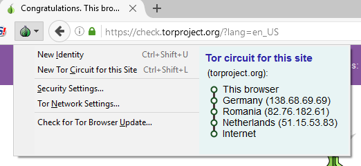

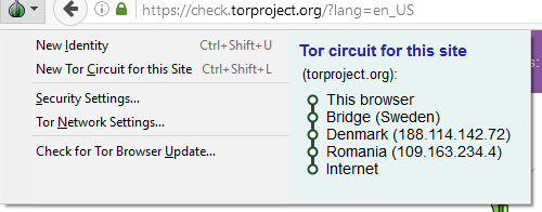

If i connect without obfs bridge, Tor shows the list of three IPs about the circuit
7f0d6f7b551ea113ad3dbd51920392ec8fb26d0d
if i connect with obfs bridge, the first IP is hidden:
4be19d4d151c6fea8583bb9315cabd76f6d030c2
THIS is the reason about the error
Unable to find IP address of Tor first node of an established circuit.
Eddie asks for info to "Tor control" about the first IP of the circuit, the Guard IP, but Tor doesn't reply in obfs mode. Need investigation if is possible or not to obtain the first IP of the circuit in obfs mode.
The ONLY reason of the talk between Eddie and Tor is only knowing the Guard IP for the reason described in the first paragraph here: https://airvpn.org/tor/
