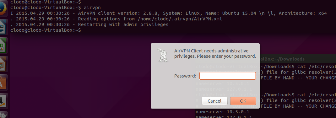

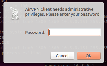

We installed a fresh Ubuntu 15.04, and installed Eddie 2.8.8 .deb edition.
Unity -> AirVPN icon, on click it shows:
b72b814309f1be06884612022e80c60b224f771b
Eddie automatically detects privileges and relaunches itself, with gksu. Automatically.
As a discerning proof, we ran airvpn from terminal.
We see logs in terminal that Eddie automatically restarts itself:
96de93e6387908f28f88b1c09041783a8b32de6a
Eddie main window never shows up if Eddie doesn't have the root privileges.
