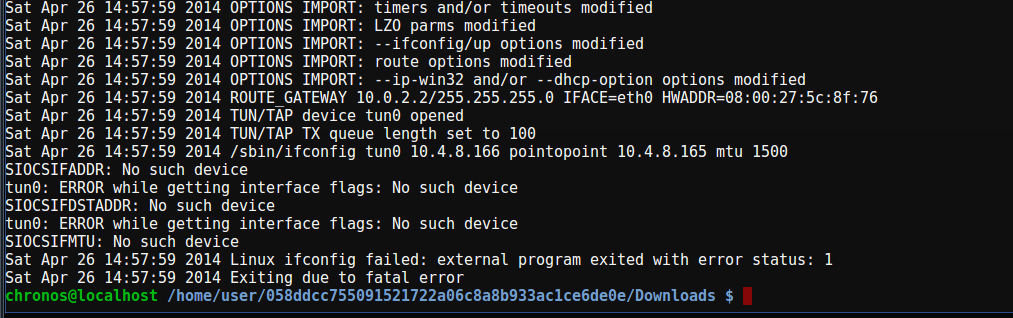

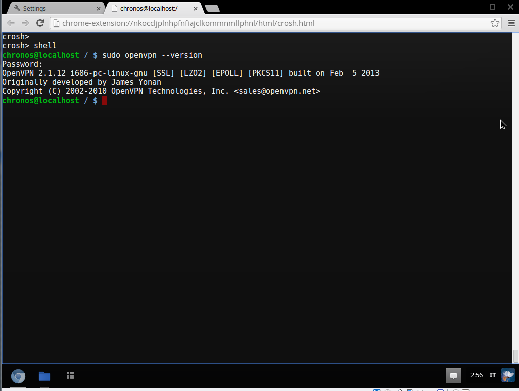

Staff 10714 Posted ... Hello!Actually, we did not find a solution to run AirVPN (in general any OpenVPN connection) with ChromeOS. EDIT: IMPORTANT UPDATE https://airvpn.org/topic/9785-using-service-via-chromebook/?do=findComment&comment=20105As far as we understand, the UI doesn't allow tls-auth, so it's impossible to configure OpenVPN through the UI. It also requires certificates conversion and a manual conversion of the .ovpn file in another custom format (!).Another attempt could be tried from a terminal:- Generate AirVPN config with Config Generator.- Open crosh with Ctrl+Alt+T.- Type 'shell'. From here, you can access the preinstalled openvpn:(password is 'facepunch' in Hexxen ChromeOS build that we run under VirtualBox)- cd /home/user//Downloads- sudo openvpn AirVPN_Europe_UDP-443.ovpn- but it fails because of an issue about the TUN driver:We have not yet found a solution.There are dozens of issues reports about ChromeOS and OpenVPN out there.We wrote this topic as an experience, in case someone wants to investigate and share a solution.Kind regards Quote Share this post Link to post

Staff 10714 Posted ... Not sure how helpful this is, but I found instructions for using open vpn on chromebookwhich I was able to confirm allowed the use of the server's CA cerificate in the vpn settings: Hello! The first problem in the User Interface is that TLS Auth is not supported and there's no room for ta.key. So you can't use the UI to configure OpenVPN. Read https://airvpn.org/topic/9785-using-service-via-chromebook/?do=findComment&comment=17289 to see where we got stuck. To use open vpn with chromebook, the user would still need to know the hostname/ip address for the servers, aswell as the username and password. There's also a field for service name and OTP, but I believe these are optional.I couldn't find server IP's or instructions on username/password in the config area here. We do not use username/password for authentication. The authentication phase (only after TLS Auth is passed successfully) is performed through certificates and client key. Kind regards Quote Share this post Link to post

mlp 10 Posted ... Got OpenVPN to work on chromebook c720 that also has crouton installed. 1) Go to crouton chroot and open terminal2) sudo apt-get install openvpn (installed 2.3.2)3) Generate credentials from airvpn site (linux, UDP, server of your choice) and save .opvn file in ~/Downloads folders4) cd ~/Downloads 5) sudo openvpn --mktun --dev tun0 (should get a message that tun0 has been created)6) sudo openvpn --config NAMEOFYOURFILE.opvn --dev tun0 That will get you up and going. Check to make sure IP has changed to airvpn servers and check for DNS leaks. To end VPN session, hit control C and it will destroy the tunnel and you will be back on clearnet. When started, the VPN works for both the crouton and chromeOS sides. After step 4, if you try to just start openvpn with the .opvn file, you get the same tun0 error message seen by the airvpn staff earlier. Making it a two step process of creating the tunnel, and then starting the VPN seems to work. I have not tried this from scratch with the native chromeOS shell, so can't comment if it will work without crouton. Good luck. 3 shaggerharris, FillUpSeeMoreHopIn and Staff reacted to this Quote Share this post Link to post
