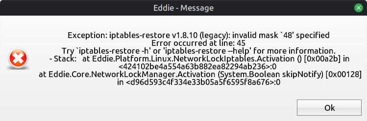

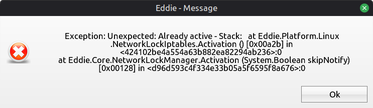

About a week ago trying to connect through Eddie fails with an error message posted below.  Trying to turn on the Network Lock before trying to connect will fail with an error message and typically causes the UI to freeze.
Attempting iptables-restore either is doing nothing quietly or fails without an error message.  It will be 'running' for 5 or more minutes without showing the command prompt before I force quit.  Hitting any key followed by the Enter key will show the message "iptables-restore: line 1 failed" and return to the command prompt.
Any ideas on how to fix this?
Quote
Eddie - Message
Exception: iptables-restore v1.8.10 (legacy): invalid mask '48' specified
Error occurred at line: 45
Try 'iptables-restore -h' or iptables-restore --help' for more information.
-Stack:  at Eddie.Platform.Linux.NetworkLockIptables.Activation () [0x00a2b] in
<424102be4a554a63b882ea82294ab236>:0
at Eddie.Core.NetworkLockManager.Activation (System.Boolean skipNotify) [0x00128]
in <d96d593c4f334e33b05a5f6595f8a676>:0
