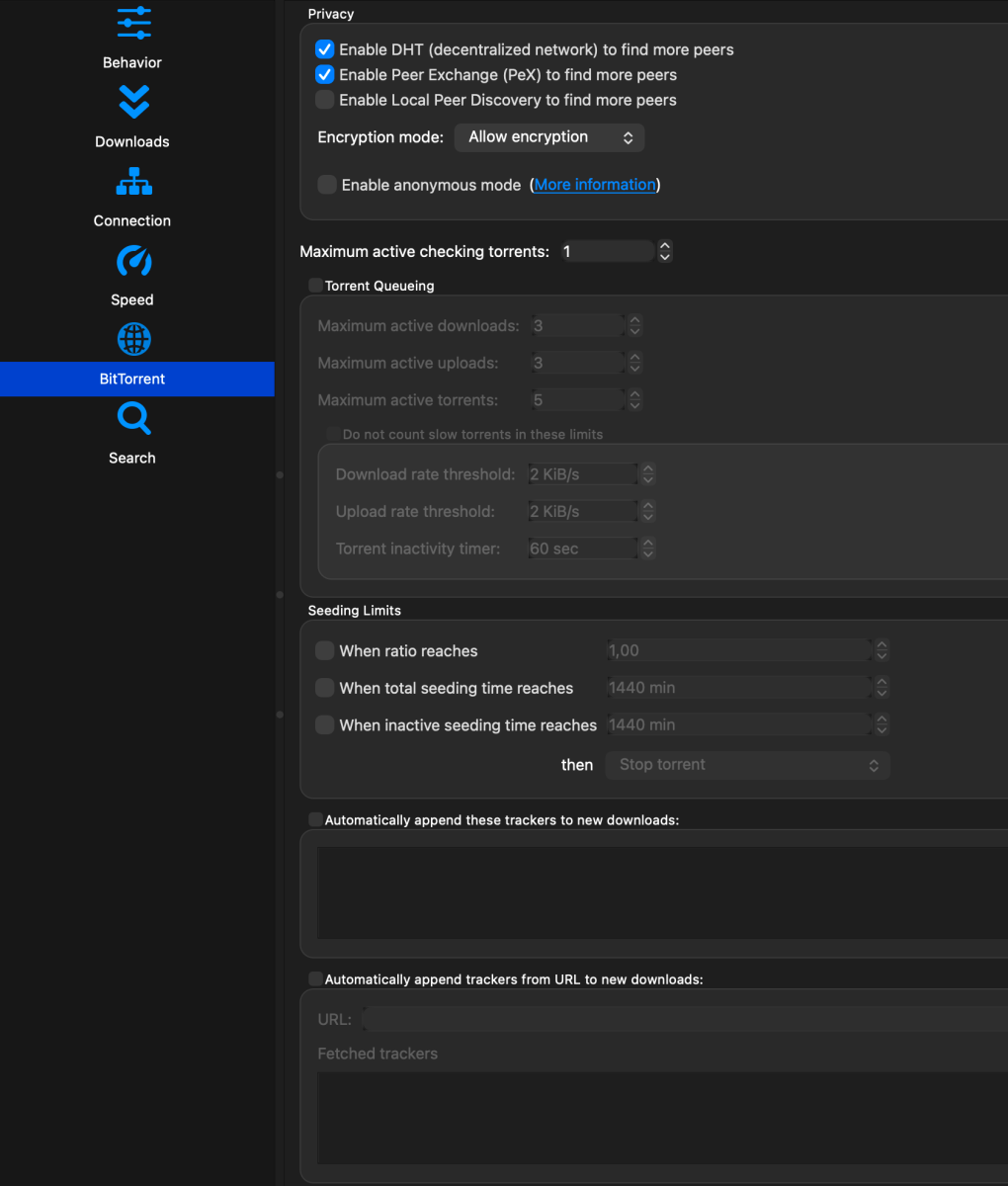

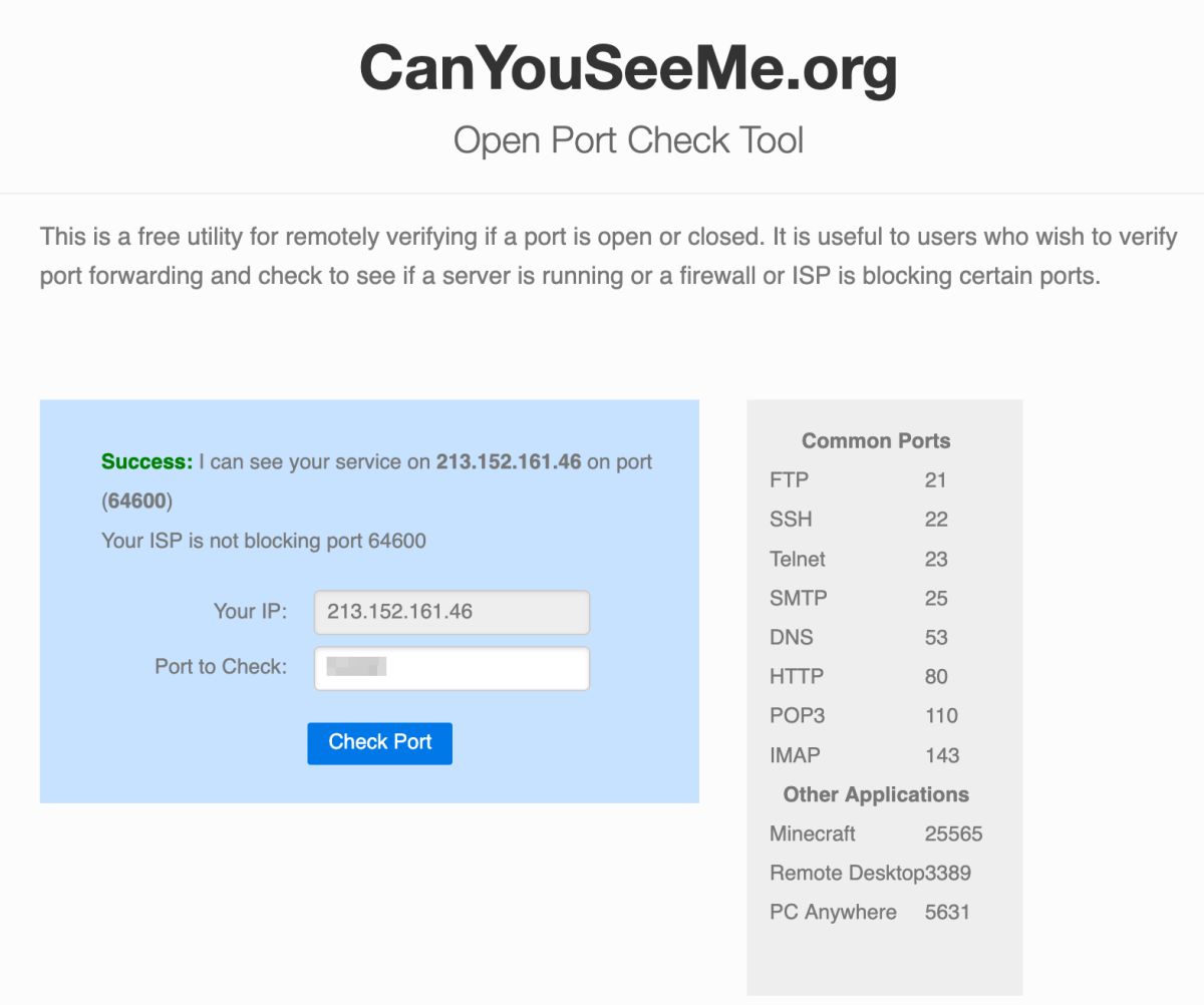

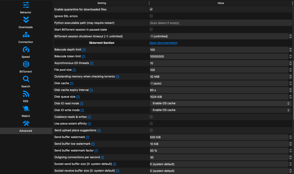

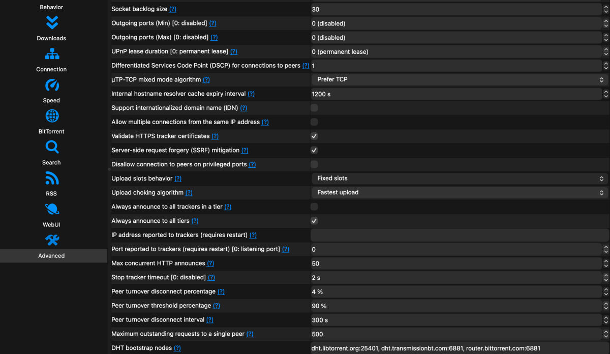

My settings (see below):
- Port forwarding OK
- QBTorrent setings : I think I followed recommandations

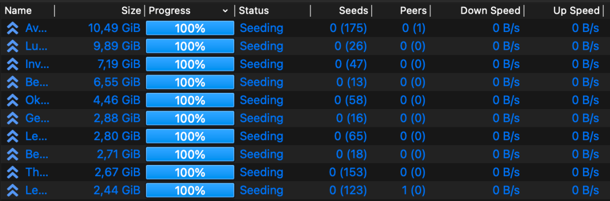

What about trying with a heavily leeched torrent on open trackers ?
In Statistics, how many Connected peers do you have ?

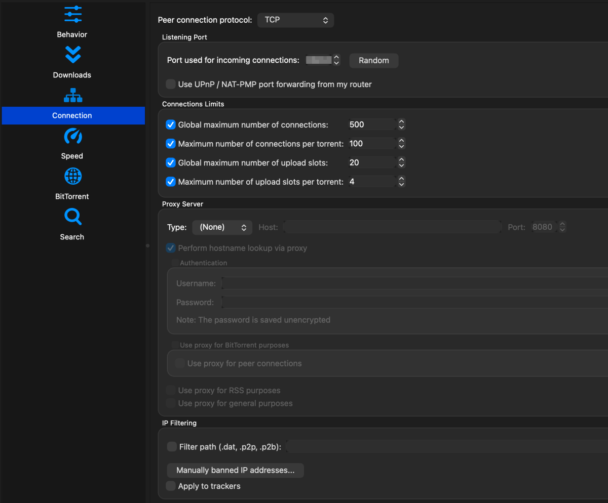

You should try without Connection Limits.
Ok, I tried with an Ubuntu ISO. It began to upload  but decreased from a few KB to zero in less than one minute. And then : no upload (at this time : 2 peers/20 connected)
0, sometimes 1 or 2... Cf. screenshot below
I tried that. The same.

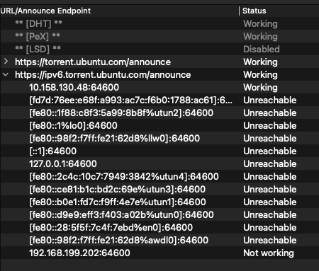

Can the problem come from (private) trackers ?

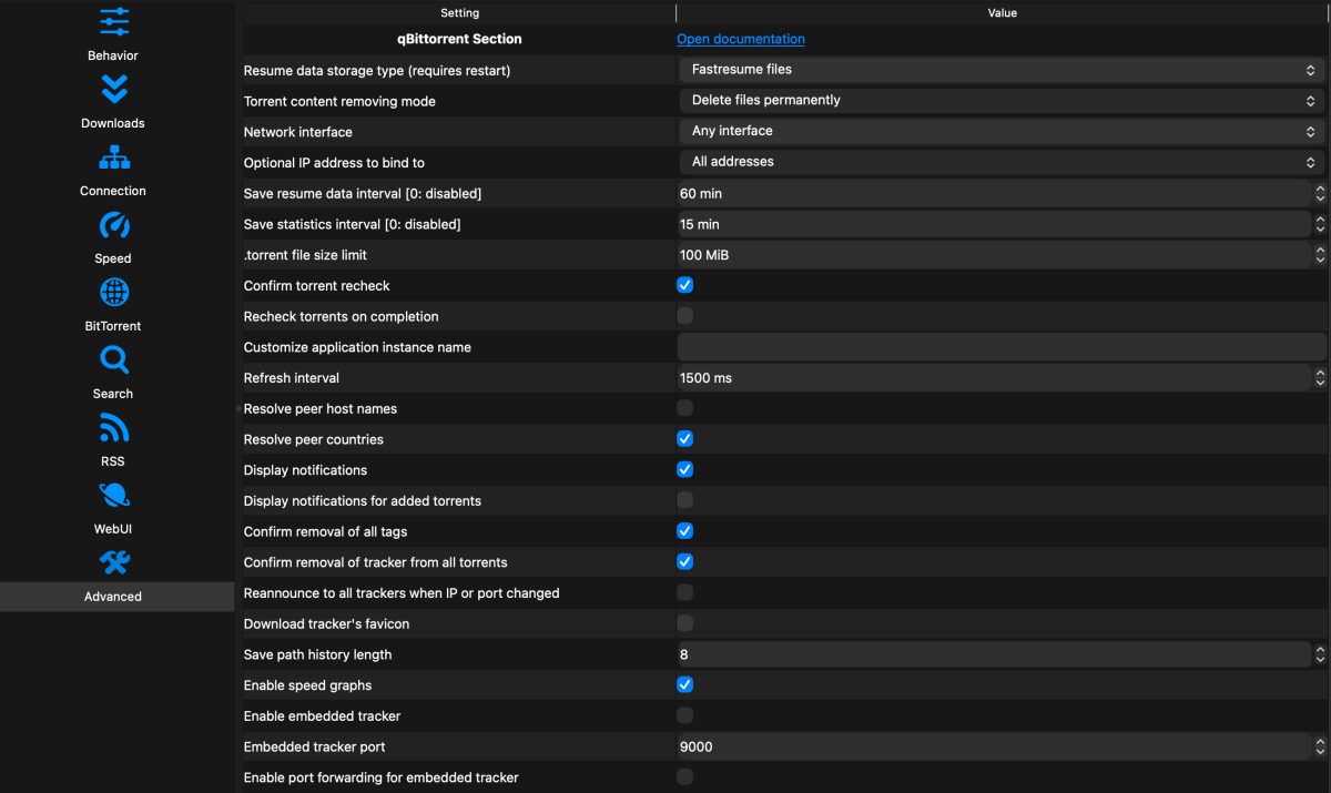

With DHT PeX enabled private trackers "block and flagg". And where did you bind the software to? Did you create a separate firewall rule to force the traffic over the tunnel?
All private trackers show this (cf. screnshot). I don't know what that means 😅

Below a screenshot with a public tracker... a lot of "unreachable" 😵💫

Disable DHT PeX LSD. Test it and see if it works with those options disabled. And bind Qbit to the VPN tunnel.
From a tracker perspective the data flow is correct. For IP v4 at least. v6 address looks blocked to me.

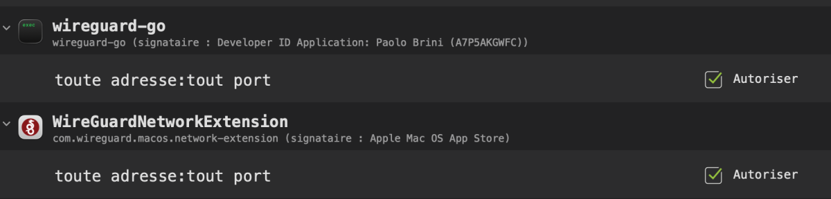

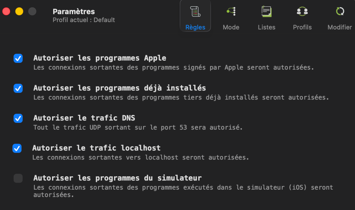

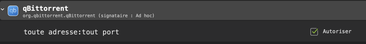

Install LuLu firewall and get to know it. The builtin firewall only blocks incoming traffic, while LuLu manages your outgoing traffic. The rest is up to you. @Staff or one of the moderators will have to assist you going further.
Here are the rules from Lulu (in french) for General, Wiregard and QB. Should I look for something else ?
I don't see any rule with a "block" setting.
OK up ! Lulu is installed. I found nothing "blocked". I tried different servers in different countries, I changed MTU settings, I tried Eddie, WireGuard, and even OpenVPN...
Nothing works.
