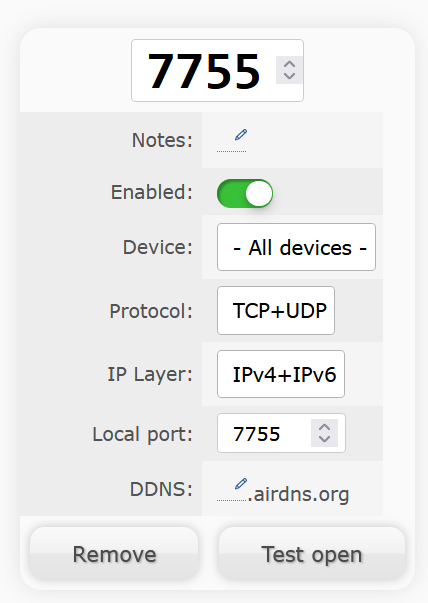

  •     AirVPN Dashboard: Port 7755 is active and assigned to my current WireGuard server.

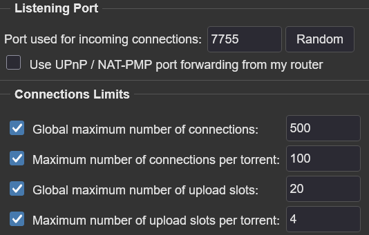

  •     qBittorrent Settings: Port is set to 7755, uTP is enabled, global upload limits are unlimited.

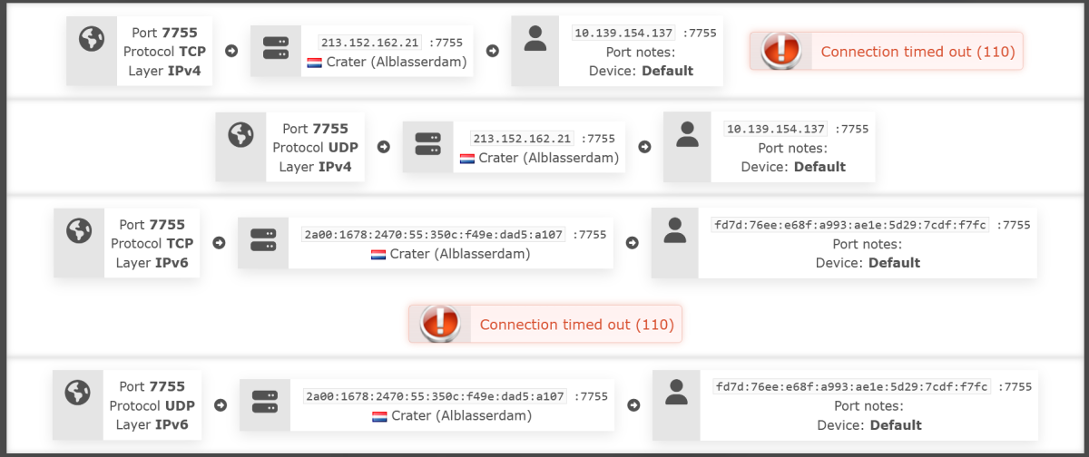

Despite these settings, I have 0 incoming connections and 0 upload speed. External port checkers report the port as CLOSED.
When monitoring the peer list in qBittorrent, I occasionally see peers attempting to connect, but they disconnect almost immediately. It seems that while I can download (the swarm can see me), external peers cannot establish a stable incoming connection to initiate a handshake.

@Kiki09
You need to set FIREWALL_VPN_INPUT_PORTS environment variable, otherwise container's firewall blocks all incoming packets on the virtual network interface. Please check the manual https://github.com/qdm12/gluetun-wiki/blob/main/setup/providers/airvpn.md
VPN_PORT_FORWARDING_LISTENING_PORTS has a quite different purpose. It sets up a redirection of incoming traffic from the VPN opened port to a custom localhost port of your choosing. As the GlueTun manual clearly warns, do not use this with torrent clients, or any other software that publicly announces its port, as that software would not be aware of the publicly visible port and would be announcing the private port instead (you can see more details of this explanation on our FAQ answer about p2p). Furthermore, it does not even instruct the firewall to allow incoming packets on the virtual network interface.
