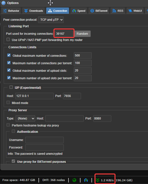

I also opened the correct port on my client area and put the same port in the .env for the FIREWALL_VPN_INPUT_PORTS variable. When I test the port on the same client area it tells me that ipv4 is reachable and ipv6 not (thats normal because I deactivated it).
In SERVER_COUNTRIES I've set Switzerland, Nertherlands and Germany. The logs from Gluetun tells me its correctly connected and I get the connection status online on qbittorrent with the port being set up correctly too :

I get around 40MiB/s on qbittorrent which is very good imo, but after 10-20secondes it goes down again to 500Kbps or maximum 2-4MiB/s, it even goes down to 0B/s.
It might be an MTU related problem. Please test again with different WireGuard interface MTU, starting from 1280 bytes and going up to 1400 bytes. The environment variable controlling MTU is WIREGUARD_MTU. Add a line on the environment: section. Example:
- WIREGUARD_MTU = 1280
Remember to re-start the container each time you change configuration.
Thank you, I've set it to 1280 as you said and tried 1300, but 1280 seems to be the most stable out of them, I'll try other values but for now Im pretty happy with the speed it has I finally reached 20-25MiB/s stable on small torrents.
