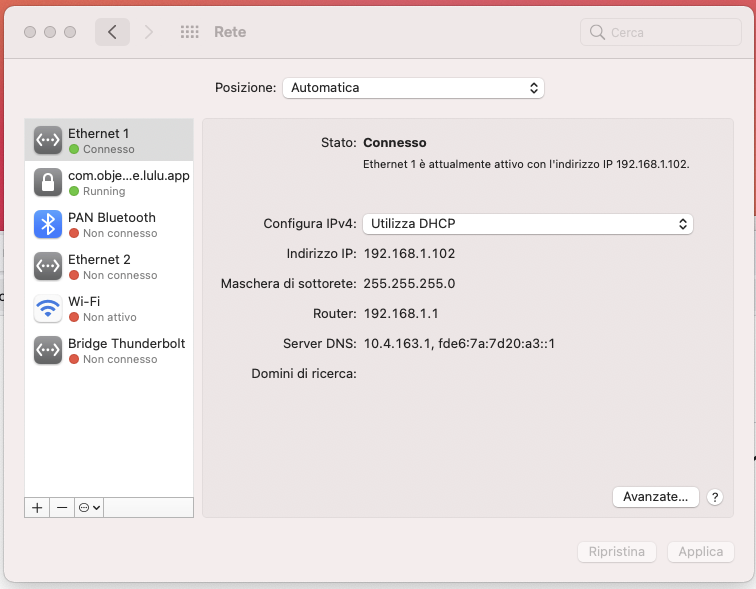

I've continuos navigation crashes and disconnections. I use Big Sur and I've read that the Tunnelblick version fot Big Sur is deprecated for serious security vulnerabilities. How I do?
Istantanea Schermo
I don't understand what's happening. In the network preferences panel, the DNS servers 1.1.1.1, 8.8.8.8, and 8.8.4.4 have disappeared.
I save them, and for a while the AIrVPN connection works, then they disappear and no longer work properly.

Thanks, I see that in the Network Panel, in the Server DNS: the system automatically adds these addresses, and when I remove them and replace them with 1.1.1.1, 8.8.8.8, and 8.8.4.4, it keeps them for a while, then removes them and automatically adds the other two. Can you explain this to me, so I can learn something I'm not an expert at all? Thanks.the system
