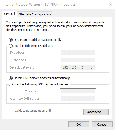

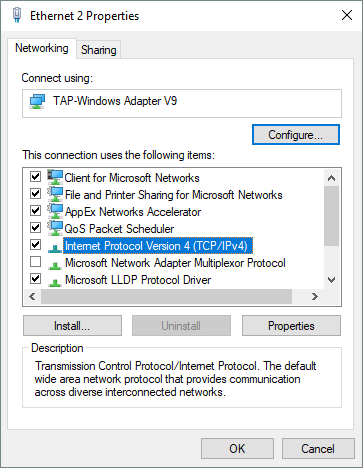

All fixed with AV support.
Steps:
reset Firewall rules
netsh advfirewall reset
Then reset my tap-9 adapter default gateway
TCPIP Properties
TCPIP Advanced Properties
Hope this help others!
Thanks for the super fast support!
V
