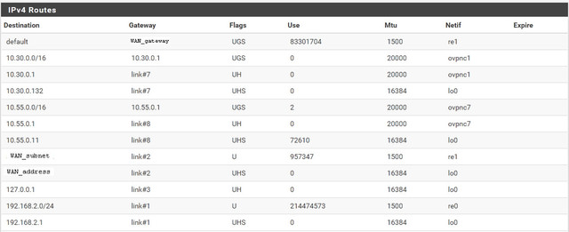

Here's my routing table with two clients up and running.  The subnets aren't the same since one of them is to a tls-crypt server now.

The OP may be on to something but I also figured if this were an inevitable problem it would be discussed a lot more in pfsense openvpn topics.

Setup a few more connections on the same ports and see what happens . But it's not inevitable as the first post in this thread fixes it .
I posted about this on the pfSense forums to which a Netgate employee replied. You can find it here:
https://forum.netgate.com/topic/131155/multiple-clients-range-overlap
There's few other threads here on the forums too, if you care to search for it.
Last but not least, I've been in contact with AirVPN tech support and they acknowledge the issue too.
I've ran for months with overlapping subnets, thinking it was working just fine. The thing is, it looks fine. If you follow the pfsense setup guide here on the forum and choose the /30 topology, people (at least I did) assume you're getting /30 so you won't have overlapping subnets. Moreover, the VPN's come up and appear to be working. You'll see counters go up under Status/OpenVPN and if you have the network graphs on your Dashboard, you'll see the graphs drawing traffic to all tunnels. Makes me wonder how many people here have this problem on their router, without actually realizing there's a problem with their connection.
So, I did a little test.  I connected to two different servers but at the same port.  So, both had a 10.30.0.x virtual address. Sure enough, in the routing table of the web GUI only "ovpnc 1" showed under the netif column even though two clients were running according to "ifconfig" at the command line.
However, when I looked at what my exit IP was according to web sites, machines that were supposed to use server "A" were reported as having server A's exit IP.  And machines supposed to use the server "B" were reported as having the exit IP of server B.
Could this just a bug in routing table display?
I really don't know.
I see the same behavior, but ipleak.net page sometimes loads only partially on a server that shares a gateway with a real link. On the airvpn.org client area, I have 2 connections now, one to NL and another to SE. NL is the "real" one, but SE is counting traffic too. It more or less matches what my pfSense graph is showing, about 1/5th of what the NL is showing.
But here's a funny one:
The SE server IP is detected, but under IP details it is showing the NL server and geolocation.
So I have no idea what is really going on, this one is beyond me. I know one thing though: it's not working correctly
So now its simple to fix this. Set each connection to a different port above and make one connection to a  Gen2 server. This is the result:
BE_Gen1_80 UDP4 	up 	Fri May 25 18:04:43 2018 	192.168.1.10:15895 	10.6.0.128 	194.187.251.90:80 	99.60 MiB / 5.42 GiB
ALL_Gen2_443 UDP4 	up 	Fri May 25 18:04:44 2018 	192.168.1.10:24410 	10.14.0.147	91.207.57.114:443 	160.08 MiB / 4.85 GiB
DE_Gen1_53 UDP4 	up 	Fri May 25 18:04:45 2018 	192.168.1.10:41624 	10.8.0.80 	185.189.112.18:53 	1.35 GiB / 6.19 GiB
SE_Gen1_1194 UDP4 	up 	Fri May 25 18:04:51 2018 	192.168.1.10:29541 	10.30.0.109 	62.102.148.149:1194 	832.47 MiB / 1.80 GiB
NL_Gen1_443 UDP4 	up 	Fri May 25 18:04:54 2018 	192.168.1.10:42418 	10.4.52.230 	109.232.227.137:443 	117.24 MiB / 6.31 GiB

Have you read about the routing table and checked to see if you an issue?
