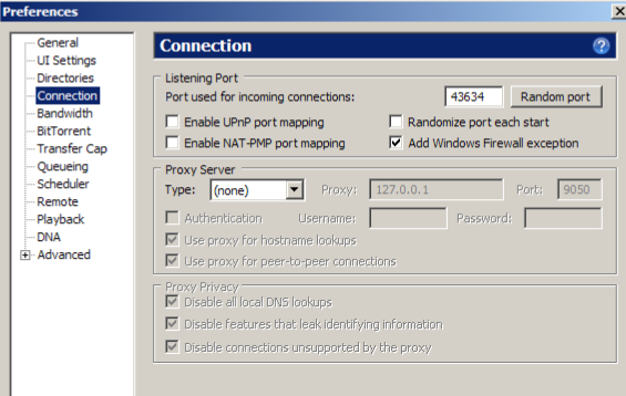

I've configured the port forwarding as it was described, but it doesn't work. Torrent client is running.
There are no opened ports on my router.
n the Forwarded ports section this port is present. But the test circle is black - no connection.
Site http://canyouseeme.org/ also says:
Error: I could not see your service on 213.152.xxx.xx on port (43634)
