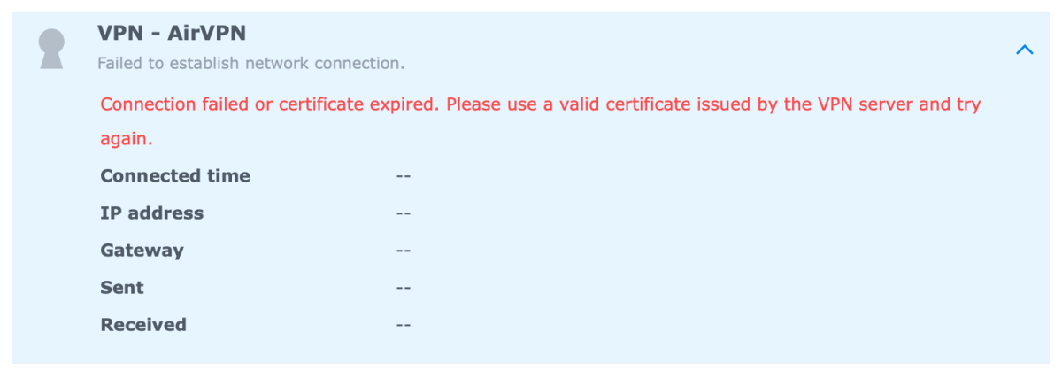

TToD 1 Posted ... I'm running DSM 7.2.1 and with the recent OpenVPN Certificate expiry issue I thought I would take the opportunity to reload my full VPN config with one generated for OpenVPN 2.5. (I was running a config for < 2.4 installed on DSM 6 before I upgraded) So I deleted my existing VPN config so I could create a new one - Big Mistake. I chose a server of Europe. The config generator gave me - remote europe3.vpn.airdns.org 443 But this didn't work, I had to change it to - remote europe.vpn.airdns.org 443 The config generator no longer provided a ta.key file, but provided tls-crypt.key instead. I used this in place of the ta.key file in the instructions. But I kept getting a connection failure on the Synology. Reviewing the different .opvm files showed: New from config generator tls-crypt "tls-crypt.key" auth SHA512 Old tls-auth "ta.key" 1 So I reverted these two lines to the single old one. But I still kept getting a connection failure on the Synology. Finally, I still had a ta.key file from an old run of the config generator, so I used that instead of the tls-crypt.key file. And lo, my Synology was now connecting correctly. My concern is, having changed those two lines to tls-auth "ta.key" 1 and using the old ta.key file, does this have a negative effect on my security. Would anyone care to wade in on whether there is a negative impact, or if I coulkd have done anything better. Thank you Quote Share this post Link to post
Staff 10653 Posted ... @TToD Hello! To clarify, be aware that europe.vpn.airdns.org will resolve into entry-IP address 1 of some VPN server in Europe. Entry-IP address 1 accepts only TLS Auth. You must have europe3.vpn.airdns.org for TLS Crypt with tls-crypt.key, and europe.vpn.airdns.org for TLS Auth and ta.key. TLS Crypt encrypts completely the whole OpenVPN Control Channel and therefore it is superior in its ability to bypass specific blocks against OpenVPN when TLS Auth may fail. Kind regards Quote Share this post Link to post
TToD 1 Posted ... 21 minutes ago, Staff said: @TToD Hello! To clarify, be aware that europe.vpn.airdns.org will resolve into entry-IP address 1 of some VPN server in Europe. Entry-IP address 1 accepts only TLS Auth. You must have europe3.vpn.airdns.org for TLS Crypt with tls-crypt.key, and europe.vpn.airdns.org for TLS Auth and ta.key. TLS Crypt encrypts completely the whole OpenVPN Control Channel and therefore it is superior in its ability to bypass specific blocks against OpenVPN when TLS Auth may fail. Kind regards Thank you for that. Yet when configuring with tls-crypt.key and using remote europe3.vpn.airdns.org 443 (basically just using everything supplied by the config generator unchanged) my synology kept getting connection failure messages. So, while TLS Crypt provides better security than TLS Auth, have the changes I made compromised the security I previously had (given that previously it was also TLS Auth)? From what you said, I would prefer to run TLS Crypt if I could get it to work on my Synology. Quote Share this post Link to post
Staff 10653 Posted ... @TToD Hello! Please feel free to open a ticket and the support team will examine the problem and suggest a possible solution. Make sure to include the OpenVPN log showing the connection attempt failure. On the client side TLS Crypt improves ability to circumvent blocks because in the first phase of the TLS negotiation the "client hello" and the "server hello" are already encrypted by the pre-shared TLS key, therefore the OpenVPN initialization remains hidden from the ISP. All the other steps are the same. You have no urgent reason to switch to TLS Crypt since your ISP does not block OpenVPN. Kind regards Quote Share this post Link to post

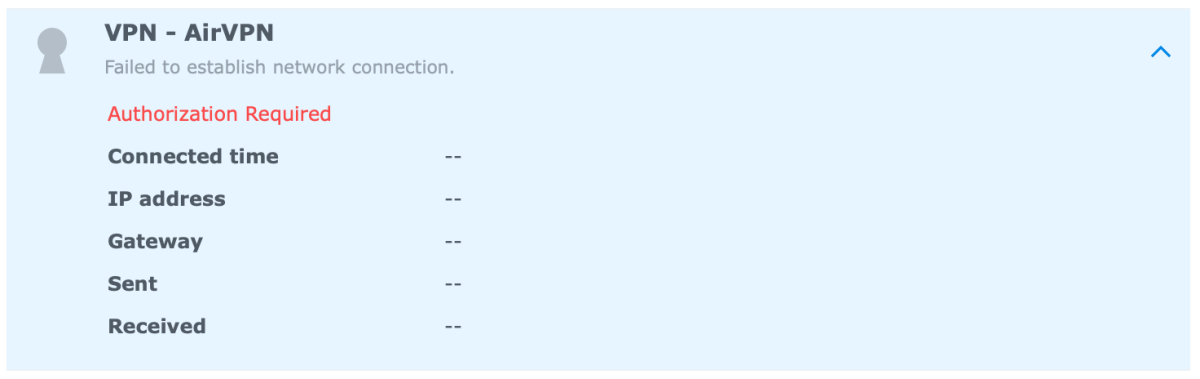

rhorho 0 Posted ... (edited) Hi The VPN connection on my Synology stopped working after running without any problems for over two years. I managed to successfully create a new VPN profile using this guide. However when I tried to start the new vpn connection I got an 'Authorizaton required' error message. When I tried connecting again it returned with a 'Connection failed or certificate expired. Please use a valid certificate issued by the VPN server and try again.' error. Any idea what I could be doing wrong here? Well the problem disappared: after starting the connection a third time it did start to work!! Edited ... by rhorho Problem solved itself more or less. Quote Share this post Link to post
lexsilico 2 Posted ... Hi, my syno config used to work for months without issue after following this guide. But since a few weeks, it does not work anymore. So I tried to delete my config on synology, generate a new one, and recreate a vpn profile on the syno. But I get the same error as Rhorho above : autorization required. Moreover, I see my connections in the VPN Sessions on the AIRVPN site. Each time I try to connect on the syno, a new session is created. When clicking to diconnect, it takes several hours to disappear. Any help appreciated. Thanks Quote Share this post Link to post
