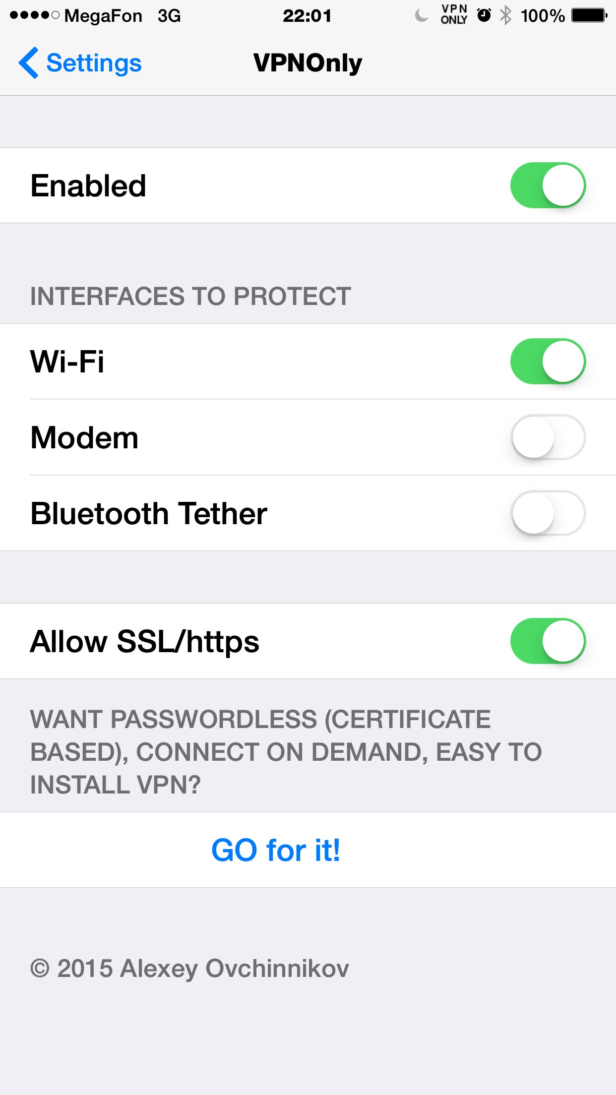

I Have iPhone 6+ on iOS 8.4
the iOS is jailbroken , i have a tweak called VPNOnly 8 from cydia which kill any network traffic if vpn is not connected
I use the Openvpn Connect app from the app store to connect to VPN
i tried some providers and the connection works
but with AirVPN i cannot connect , i think there is a conflict with the tweak that prevent me from Connecting to AirVPN
I Also figured that if I enable an option in the tweak called " Allow SSL/HTTPS " i can connect to the AirVPN servers
but in that way my phone will accept ssl and https connection if vpn is not connected and i don't want this to happen
I tried all ports available from the config page in client area and both TCP/UDP and i had no luck !
here is a picture for the tweak :
by default connections to an Air VPN server go to port 443 and this may cause the problem.
Maybe the program you cite blocks outbound ports to prevent leaks, and blocks outbound port 443 unconditionally, unless you allow HTTPS. Try to connect to port 2018. In order to see all the possible connection modes in the Configuration Generator tick "Advanced Mode". Then, you should tell that program that is should not block traffic to port 2018.
