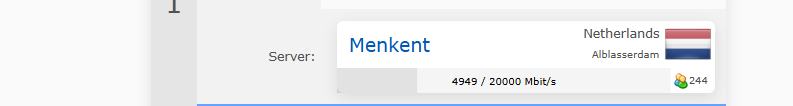

try airvpns 10gbit server for netherlands
they give me better speed here in canada
i have a symmetrical 1gbps, most regular 1gbit servers are slow for me.
Well i want, but how i can find them? It's not marked anywhere, or maybe I just didn't see it.
I tried this one, its worse.

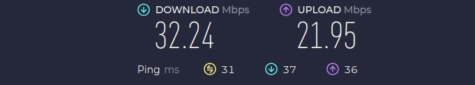

I did the test with Eddie software in my windows, and i have 700Mbps connexion, and i have only 32 Mbps in all my container, don't know why...

the server you included in the screenshot is the 10gbit one.
