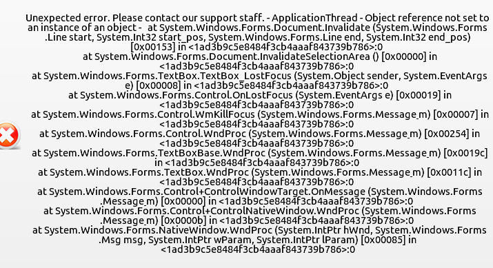

In the case of Eddie, that command which can yield all that info in a concise manner is the system report accessed like so, so please launch Eddie, connect, then provide a system report:.
