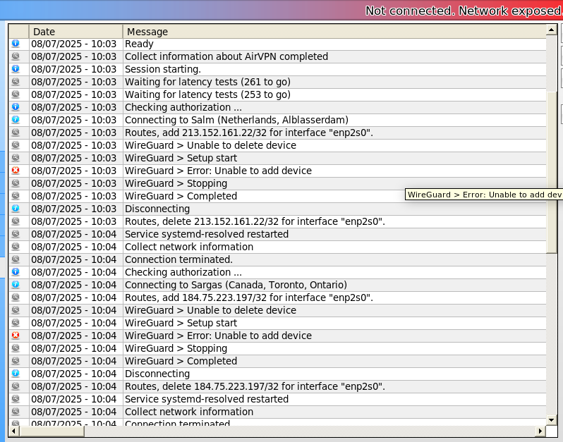

Please see attached - this is with network lock disabled and then a restart of the program. I would obviously like to get working with 'network lock', but I guess one thing at a time.
Please help.
I have actually now resolved the issue using AI. I did not have wireguard installed properly and also had to force load it on startup. now it appears to be working!
