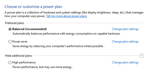

Step 2. Here click on Change plan settings to the plan that is selected here. Below you can see that the default selected plan is Balanced.
choose-or-customize-a-power-plan

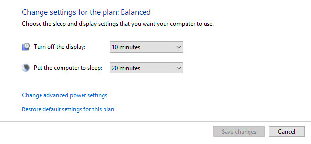

Step 3. Now click on Change advanced power settings.
change-settings-for-the-plan

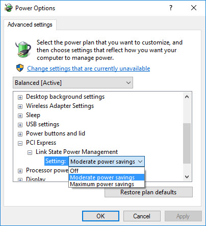

Step 4. The Power Options window will open and here scroll down to expand PCI Express and then Link State Power Management. In the Settings drop-down box, select Off and click Ok to save the changes. You may also have to restart your computer to make sure the changes have been applied.
windows-power-options
After this, your graphics card PCI-Express slot will operate at full speed and you may see higher GPU usage and performance in games. Some users have reported at least 10 FPS increase in games after turning OFF Link State Power Management setting in Power Options.

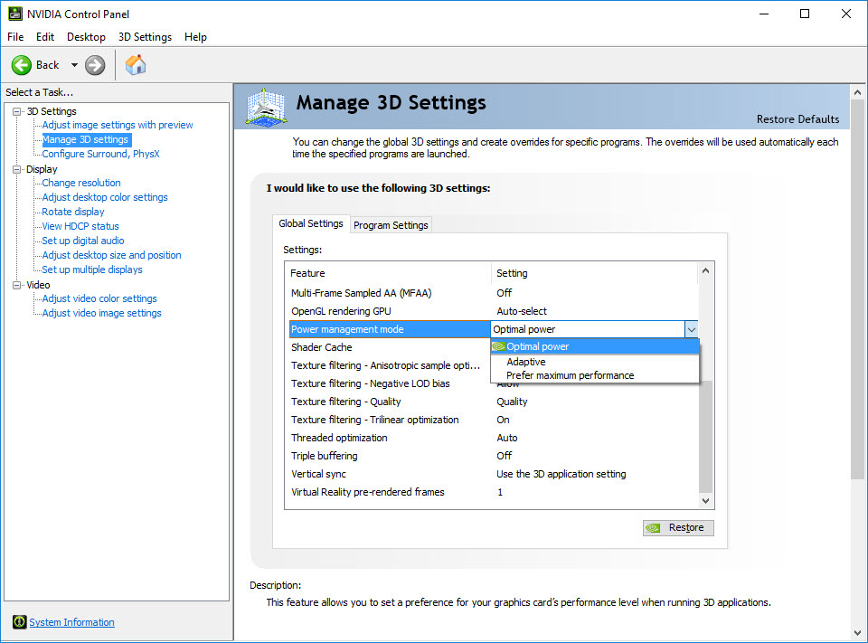

Moreover, Nvidia also has power management settings in their control panel that you can set to maximum performance if you are still having issues with low GPU usage. To set it to maximum performance, go to Nvidia control panel->manage 3d settings->power management mode->prefer maximum performance. This is shown in the image below.
nvidia-power-management-mode

No, the graphics card didn't limit internet speed. I just inadvertently found the solution to that while trying to find out why my graphics card wasn't using its full resources while gaming. In the graphics card help post ( link above) I found the passage on "Windows Power Management Setting for PCI Express"  was what had slowed not just my graphics card but my whole PC down. My CPU very rarely ran at its full 3750MHZ but mostly between 1200-2200MHZ. When I switched the "Link State Power Management" off as shown above suddenly my PC is much faster overall including my internet and broadband connection and my VPN connection goes from 250Mbps to near 600Mbps D/L compared to a regular 800+Mbps D/L without using aVPN.
