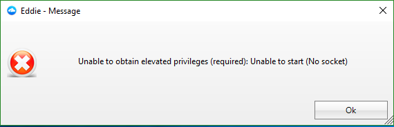

The first problem I encountered with this new version after a few days of testing:
I have set Eddie to start when my system boots.
After I booted up my system, the Eddie splash screen appeared for at least a minute and then I got the following error message:
Sadly, Eddie shut down immediately after I clicked "ok" so I couldn't save any system logs. I'll add the log from the first time I started Eddie after this crash.

Win 10 Pro 18363, cant get Eddie 2.18.9 to start with Windows.
Ive checked the tick box and its in Windows Startup but I have to run it manually.
I was also getting Connect with daemon for system privileges  error.
I resolved that by elevating to run with Admin privileges.
My other PC, still running 2.13! Works fine.
Disable Fast Startup.
Came here to say that this tip of yours has been working for three days straight now. I had found it in the 2.19 beta thread.
Thanks a lot!
