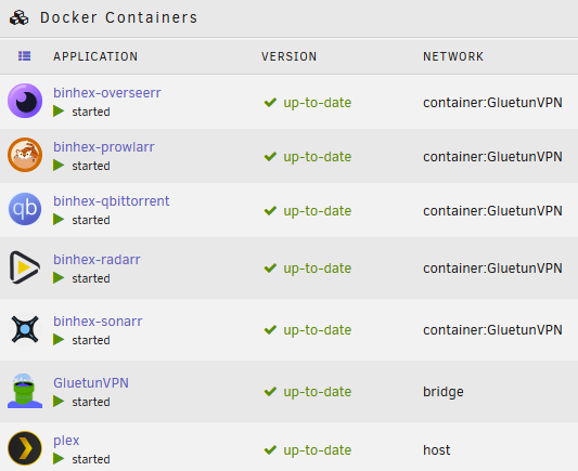

EDIT: I managed to setup Gluetun and everything seems to be working.
Thank you for the assistance.
