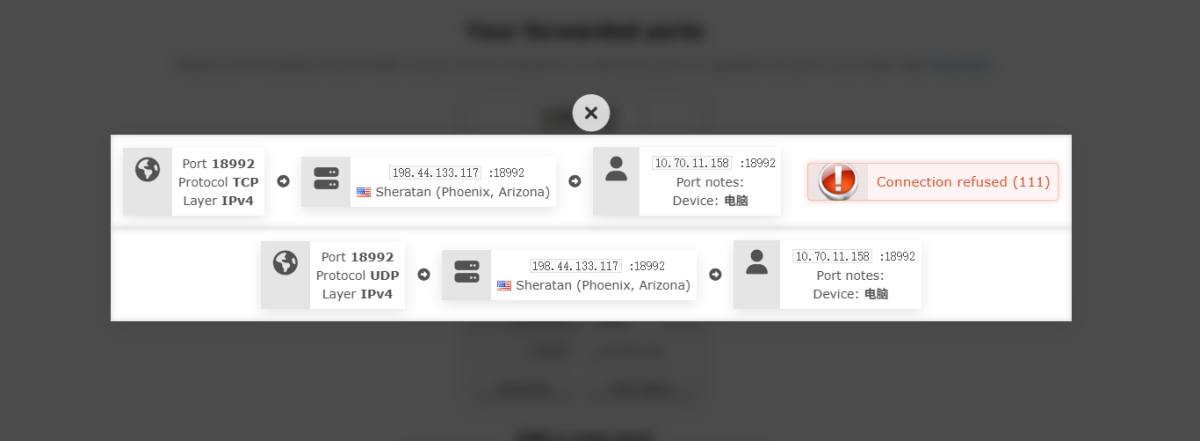

EMULE 19 Posted ... Hello, I can connect to the server, but port forwarding is not working. A port test shows "connection refused." I need help. Share this post Link to post
EMULE 19 Posted ... Is it my ISP blocking it? It used to work fine before, but it recently stopped working. Share this post Link to post
Tech Jedi Alex 1531 Posted ... Connection refused means it was able to connect but on your host nothing is listening on port 18992. 1 EMULE reacted to this Hide Tech Jedi Alex's signature Hide all signatures NOT AN AIRVPN TEAM MEMBER. USE TICKETS FOR PROFESSIONAL SUPPORT. LZ1's New User Guide to AirVPN « Plenty of stuff for advanced users, too! Want to contact me directly? All relevant methods are on my About me page. Share this post Link to post
EMULE 19 Posted ... 5 hours ago, OpenSourcerer said: Connection refused means it was able to connect but on your host nothing is listening on port 18992. There’s nothing listening on the port? I’m using Windows 11, the network firewall is turned off. I’m currently using Eddie version 2.24.6. Is port listening managed by Eddie? Is it an issue with my computer system? I switched to using Eddie on Android and still got connection refused. What should I do? Share this post Link to post

EMULE 19 Posted ... Of course, none of my applications can connect through the forwarded port, and changing the port doesn’t solve the problem either. Share this post Link to post
Tech Jedi Alex 1531 Posted ... Then it's probably not listening on the VPN interface. What program are you trying to reach via VPN, anyway? Hide Tech Jedi Alex's signature Hide all signatures NOT AN AIRVPN TEAM MEMBER. USE TICKETS FOR PROFESSIONAL SUPPORT. LZ1's New User Guide to AirVPN « Plenty of stuff for advanced users, too! Want to contact me directly? All relevant methods are on my About me page. Share this post Link to post
EMULE 19 Posted ... eMule. I’ve already made sure that the eMule listening port matches the VPN’s forwarded port. Yet I still get a Low ID, whereas before I used to get a High ID. That shouldn’t happen—ideally, once the VPN tunnel is successfully established and the server forwards the port, the client should be able to communicate over that port through a properly open public network. The ISP can’t possibly intercept a port’s communication through the VPN tunnel, right? Share this post Link to post
Tech Jedi Alex 1531 Posted ... I see. Have a look at these.. 1 EMULE reacted to this Hide Tech Jedi Alex's signature Hide all signatures NOT AN AIRVPN TEAM MEMBER. USE TICKETS FOR PROFESSIONAL SUPPORT. LZ1's New User Guide to AirVPN « Plenty of stuff for advanced users, too! Want to contact me directly? All relevant methods are on my About me page. Share this post Link to post
EMULE 19 Posted ... Thank you very much. Port forwarding has resumed normal operation again. It was an issue with the Windows 11 firewall. Although the firewall had previously been turned off, at some point it was automatically re-enabled—probably due to a Windows 11 policy. Once I disabled it again, everything worked fine. Thank you. I really appreciate your help. Share this post Link to post
