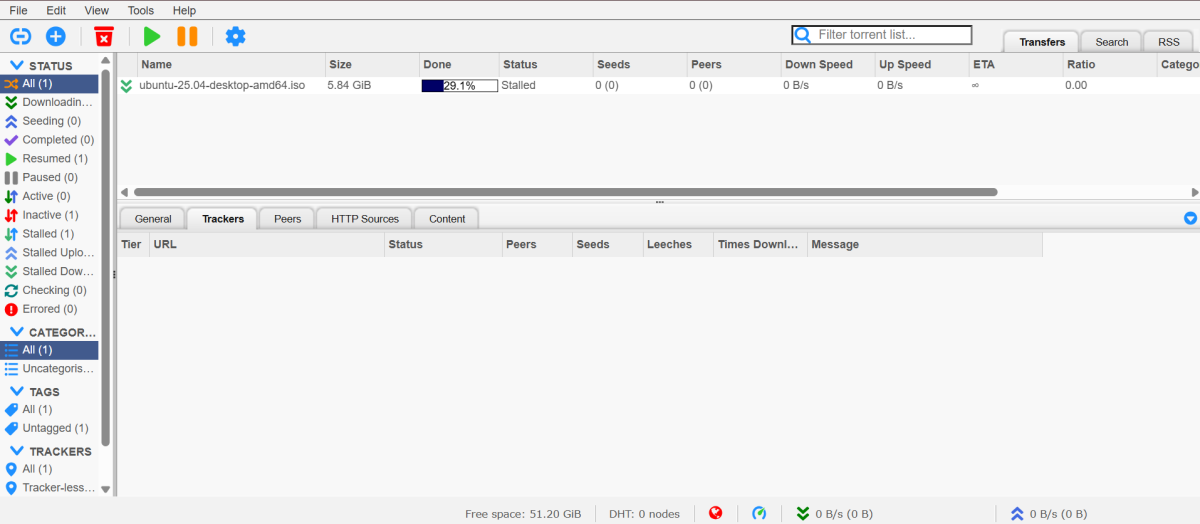

Hi! I am trying to run qBittorrent off my headless Raspberry Pi, connected with AirVPN. Without VPN, torrenting has been working, however it has stopped working once connected with AirVPN.
I am using a headless Raspberry Pi and connected with eddie-cli. I have logged in and confirmed that I can connect to websites with the VPN running.
I am using qBittorrent via the Web UI, and I have bound the adaptor to Eddie.
I have enabled AirVPN port forwarding in the Client Area and set qBittorrent to listen on the same port, and enabled this port through my firewall.
I am honestly stuck on how to continue troubleshooting - any advice on troubleshooting qBittorrent and AirVPN via the command line would be very appreciated!

Can you view the qB log in the WebUI? Or does qbittorrent-nox log to STDERR or something? In any case, qB logs would probably help.
Thanks for suggesting the logs - I was able to find them and found that despite setting the port in the WebUI, it still wasn't listening on the right port, so I changed it in the config file.
I have tried setting up the VPN in with Goldcrest, OpenVPN and Eddie CLI, but I am still getting the same issue :( . I have also since confirmed with the API check that I am connected to AirVPN with my current setup with OpenVPN.
This is currently what my logs look like:

After I first set up and started the VPN, the logs said it had successfully connected. I think this was still just set to Any Interface and is connecting to ethernet.

In both cases though, qBittorrent still showed red when set to the tun0 adapter, and flame when set to any interface, whilst connected to AirVPN. When not connected and set to Any Interface, it shows green.
