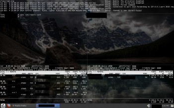

You could install something like jnettop and run it on tun0 and wlp3s0 in separate terminals. From there you should be able to see packet travel ect.
jnettop -n -i wlp3s0
^ wlp3s0 should only show your wlp3s0 ip connecting to the airvpn server/port.
jnettop -n -i tun0
^ will show the tun0 ip connecting to site ip's ect.
Other than that if you're not getting openvpn startup or connection errors and all the ip/dns test are clean, run it.
-The only other thing I might add to that script or a script is a resolv.conf rewrite. Just making sure the dns servers are the air dns servers while the vpn is connected.
Thanks very much for this!
Yup np. jnettop is good stuff.
If you toss it all in the terminator terminal its sexy time for linux lol.
-note my res and dpi are a bit wonky, downside to a large lcd.
