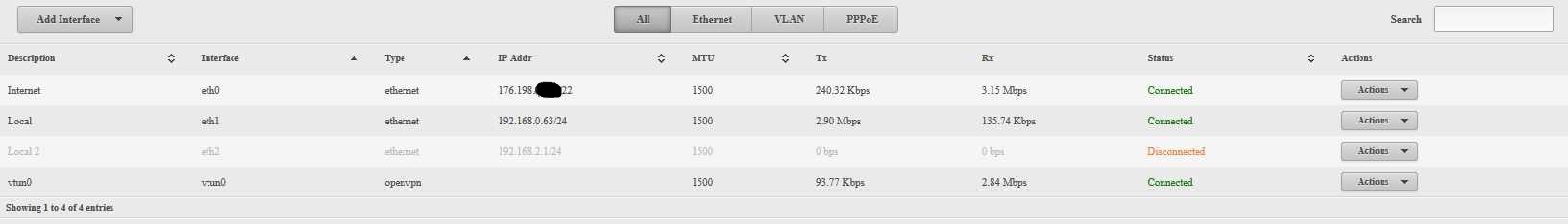

LazyLizard14 11 Posted ... After some testing with the AirVPN client under Windows I proceed to set up the VPN connection on my router so all my computers can make use of it. But when the VPN tunnel is established from the router I only reach a speed of just about 7 MBit/s. When connecting with the Windows client (same port, protocol and server) i get about 30 MBit/s! The router quite powerful (Ubiquiti Edgerouter Lite) and not the bottleneck in terms of performance.What could cause this behavior? MTU? On the router the vtun0 interface is up with MTU 1500.I'm clueless and need some advise for troubleshooting Quote Share this post Link to post

LazyLizard14 11 Posted ... Hardware InfoDatasheetUnlikely that the router is causing the slowdown, especially as the cpu load is floating well below 20% . Quote Share this post Link to post
