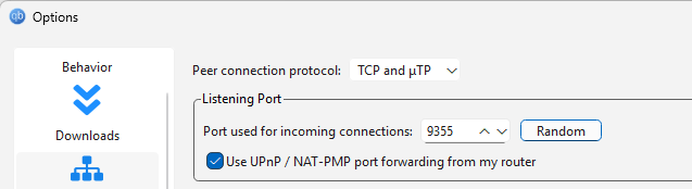

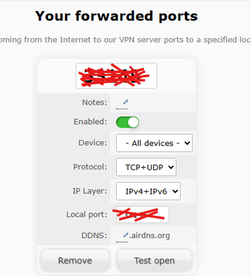

2) Choosed a random port (hmm, not really 9355 ;) Do I let the case Use UPnP... checked ?

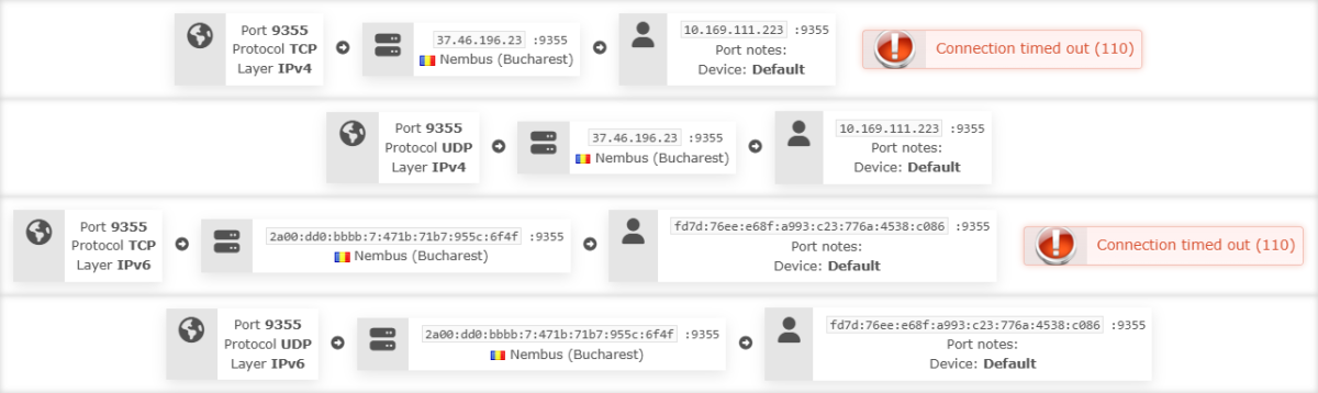

And set the same port in my page https://airvpn.org/ports/ :

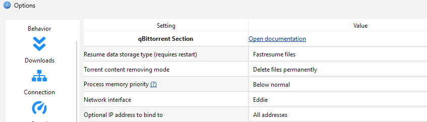

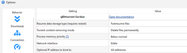

1)      I read that I have to link QB with the IP of my VPN.
Where do I find the value of this IP ?
Then, where in QB i set it ? In my first print screen above "Optionnal IP address to bind to" ?

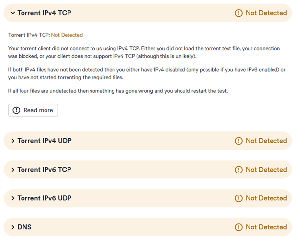

2)      I’ve been to https://www.top10vpn.com/tools/do-i-leak/ and
-          "VPN Leak Test" shows a DNS leak. Is it an issue, for torrenting ?
-          "Torrent IP Leak Test" : I installed the 4 magnet Magnet Link in QB, where they doesn’t download :
                Result of the test :
Why are they not detected ??
From what I can decipher through the "blur", you forwarded a 5-digit port while you set port 9355 in the torrent client. As such, they are not the same, and no one can reach your client.
You don't need that if you bound qB to the interface.
They are not meant to be downloaded, but they are meant to contact the tracker in the magnet link. This is not working, probably because your forwarded port is not the qB port, see above.

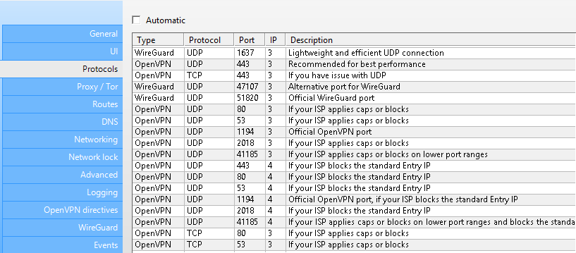

Not really. Try different servers, ports and protocols to find the best combination for you.

Same problem as above, forwarded port != qB port.

An other question, please : you tell to try different protocols..
What does it means ? Change UDP by TCP ? (Maybe it's better I let 'Automatic' for the moment ?)
Before Wireguard I meant exactly that, but now I also mean to try both OpenVPN in TCP/UDP and Wireguard.

I tried some protocols (Disconnect+Reconnect) / servers manually, but in my page https://airvpn.org/ports/ I do F5 to refresh the page, then "Test open" always show me the Timeout issue :
Then I came back to Protocol "Automatic", as it was working previously, but now, I always get a Timeout, whatever is the server. I tried to close Eddie, restart ... No way ':(
What happens, please ?
Thank you !
I answer to myself, it could be useful for some other newbie like me the button "Test open" works only if a software (e.g. qBitorrent) is listening.
