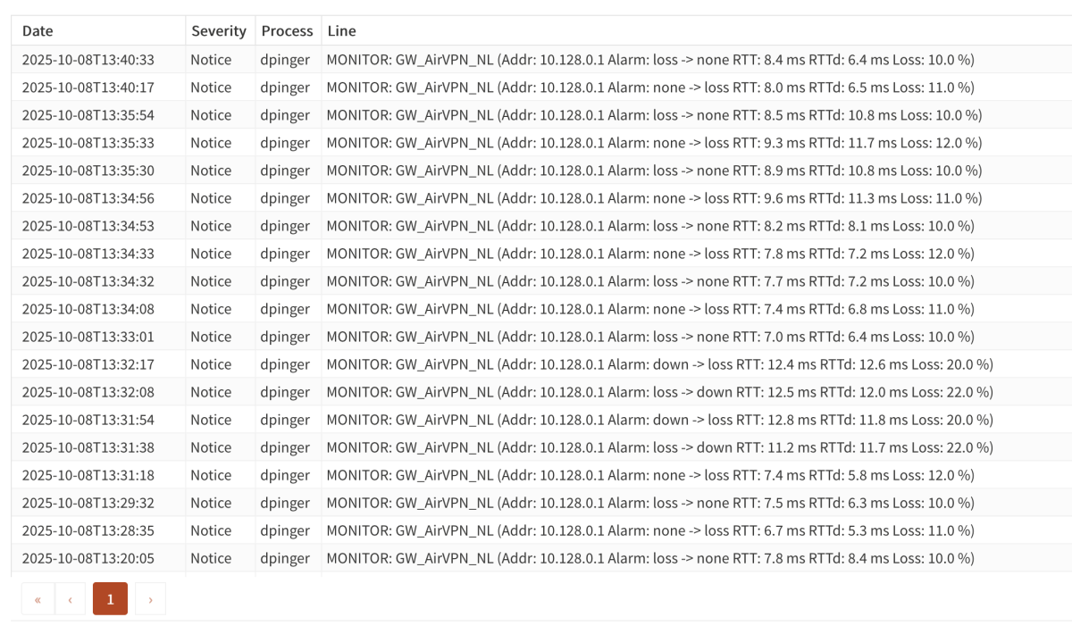

I got the same issues with packet loss of 5-20% last couple of weeks on Dalim and Menket servers.
Generally, I don't have any packet loss on my WAN.
According to AirVPN statistics, these servers are relatively underutilized.
Is it the AirVPN problem itself? Or servers?
