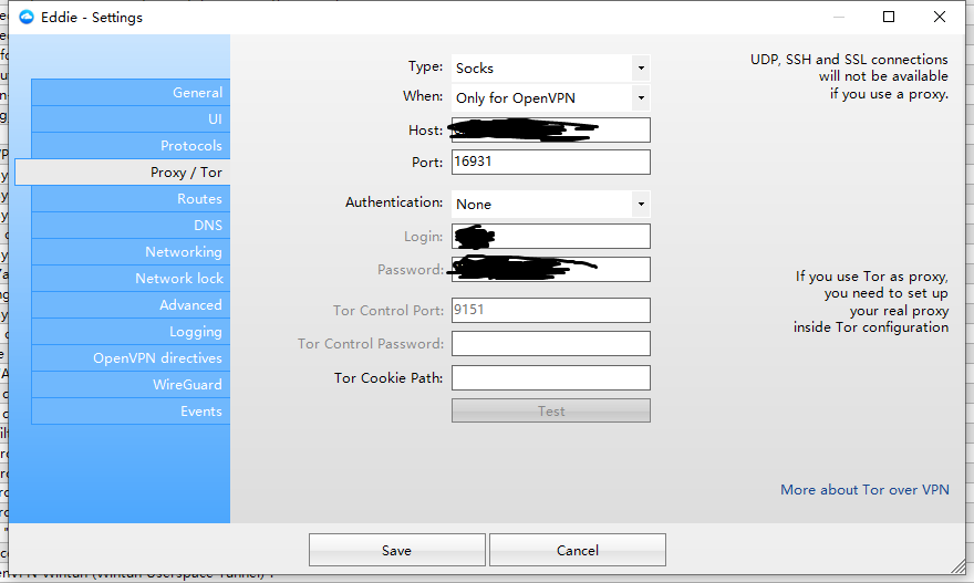

I found an interesting phenomenon. When I turned off the account and password of the cloud host's proxy server, I successfully connected to the server through socks,I uploaded a log file, which contains the successful connection records of HTTP and SOCKS. However, HTTP has identity authentication, while SOCKS does not, only the IP address and port.I uploaded a log file, which shows the successful connection to the server using HTTP and SOCKS. However, HTTP has authentication, while SOCKS does not, only the IP address and port. I also uploaded a screenshot, the graffiti part is the account and password used when choosing HTTP as the proxy. At least I have successfully connected to the server via SOCKS.
As mentioned above, I turned off the authentication of the cloud host's socks proxy server, leaving only the port, and Eddie connected successfully.My English is not very good, I'm sorry, but I think I can express myself clearly, right?
So the SOCKS proxy did not need any authentication, can you confirm? If so, it is then possible that the error message thrown by OpenVPN was misleading, i.e. the auth file was fine (the auth file is a text file containing username and password for the proxy on 2 lines) but not accepted by the proxy, or Eddie did not create it properly (further investigation needed).
