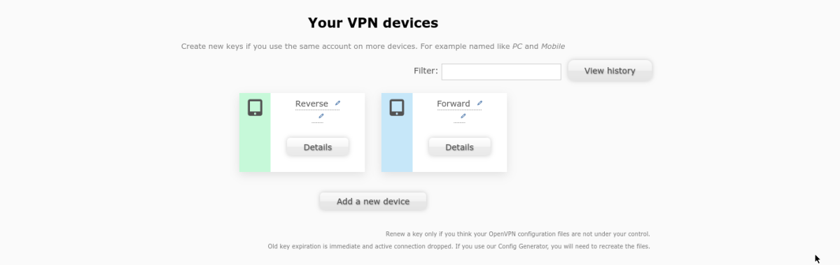

Thanks. Yes they're distinct; remote machine is Carinae and local is Alathfar. I'm not familiar with the keys suggestion though. Is that related to the Devices settings? Right now my remote machine is set to be 1 device, although the local machine is using Default. Should I try creating a distinct key for my local machine's connection?
Go to client area-> VPN Devices->Manage, then add a second device for your remote machine. Make sure to select that new key when using Eddie on the remote device, or, if you're using the config generator, choose the new key when generating the config
Go here using AirVPN website, ensure both machines have a different key, and reconnect one of your machines(I suggest reconnecting the remote machine) under a different key. If it still doesn't work, disconnect both sides from AirVPN, wait 5 minutes, and reconnect on both sides, ensuring that you selected a different key on both sides even before you start a connection.
You are a legend! That worked. Having a separate device set for my local machine was the solution. It seems for this to work, both machines need to be set up as different devices and must be connected to different servers. My Remote Desktop is now connected as intended. Thank you!!
