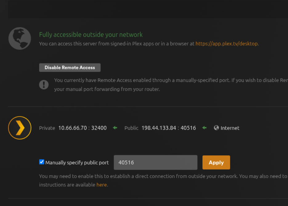

I cant manage to access my Plex server with VPN, port 63132 is ready for use in client area:
Plex settings:1364312653_Screenshot2024-03-03alle12_01_32.png.08b0573b27bb60b345e44d52b07e8f21.png
If I click "retry" in Plex setting it works (I can access to my library externally with no problems) but after a few seconds It won't work.
Can you help me? I already read this topic but I didn't help me. I think that I set up things correctly.
@matteoar1
We get a "connection refused" (error 111) when a packet is sent to your VPN client port 63162. The packet reaches your node and the connection is actively reset. It's possible that a firewall rejects the packet (instead of silently dropping it) or that nothing listens to port 63162 and the system is configured to reset any attempted connection when the destination port doesn't exist.

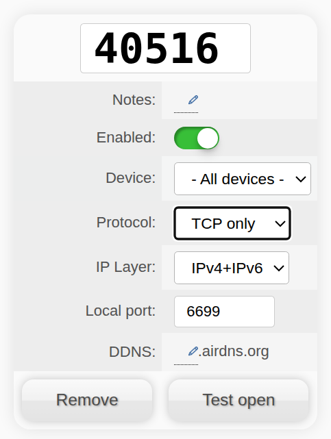

Plex ignores your setting (port 63162 does not appear anywhere).
From the documentation, we can infer that the "public port" is only used to announce it through Plex centralized system to clients to facilitate connections, authentication and other purposes, and then it is required that some Plex upstream (the router or system packet mangling tool) re-directs incoming packets to port 32400.
Try to re-map port 63162 to your port 32400. If Plex announces to clients public port 63162, clients will contact AirVPN server IP address on port 63162 and the server will forward the packets to your Mac utun interface port 32400. Since Plex listens to port 32400 of all interfaces in IPv4 and IPv6:
Plex\x20M   728         matteo   18u  IPv6 0x5e8f1037afa692f5      0t0    TCP *:32400 (LISTEN)
(about why lsof in BSD and Linux shows an IPv4 and IPv6 socket only as IPv6 see here)
then your Plex should become reachable. In order to do so just add "32400" to the "Local" field of your remote port 63162, in your AirVPN account port panel.

I have the very same problem:  Plex server become accessible just for a copule of secs, then it goes back to unavailable.
I have been trying this since yesterday:  yestrday I wasn't even able to have it working for a couple of sces, today, even if I din't change anyting, I have the server working for a couple of secs like mattear1 was mentioning.
I'm have been trying this since yesterday:  yestrday I wasn't even able to have it working for a couple of sces, today, even if I din't change anyting, I have the server working for a couple of secs like mattear1 was mentioning.
Please let us and the community know in case Plex support or community find a solution to this problem, thanks in advance! The OP had his problem suddenly solved without an explanation.
Well, it happened again:  all at once it connected and my server is fully available outside since 3 hours.  Port is configured as follows: I remapped Plex port, but am quite sure it doesn't make any difference without remapping...anyway give it a try.

## Step 1: Configure VPN Port Forwarding
Get your forwarded port from AirVPN . This will be the first link in the chain.
  1. Log in to your VPN provider's control panel (the first image shows AirVPN's panel).
  2. Request a new port forward. Note the two ports it gives you change the Local Port diffrent from the main one:
    • External Public Port: The port the outside world will connect to (e.g., 40516).
    • Internal Forwarded Port: The port your gateway VM will receive traffic on (e.g., 6699).

## Step 3: Configure Plex Remote Access
Finally, tell Plex about your custom setup.
  1. In Plex, go to Settings -> Remote Access.
  2. Check the box for "Manually specify public port".
  3. Enter the External Public Port AirVPN gave you (e.g., 40516).
  4. Click Apply. Plex should briefly check the connection and then show the green "Fully accessible" message. I wouldn't trust Plex port checker use the AirVPN one as it is more robust and won't give false positives.
Your Plex server is now fully accessible from outside your network through your secure VPN gateway. Once you confirm Alpine is set up properly you can now set the drive to be read only as good practice. Make sure you untick Enable Relay in network in Plex to avoid using the unreliable and slow speed network. if you have issues check you have right ports forwarded in alpine with iptables -t nat -L PREROUTING --line-numbers
