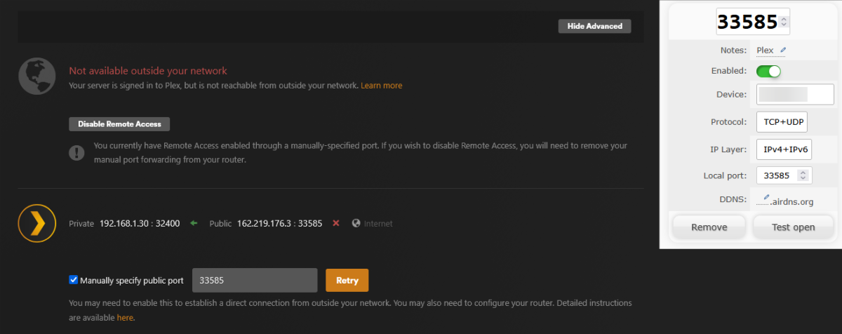

I am getting the same problem as well. Is there something that I am doing wrong? ESET firewall rules for Plex is already allowed both directions, any port, TCP and UDP, and it still fails. Do I have to set local port to 32400?

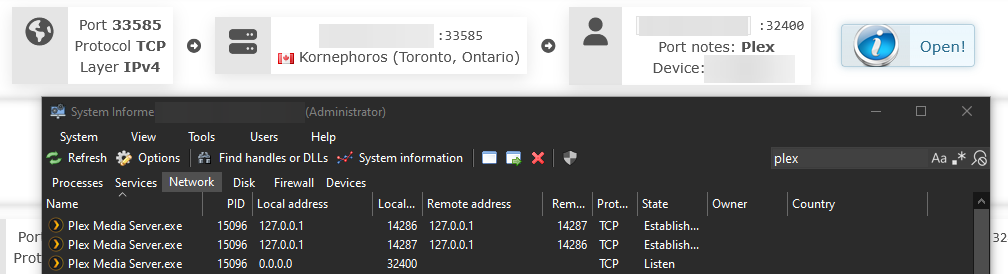

Yes, keep in mind that Plex always listens to port 32400 of the VPN interface, no matter what. Therefore you should "re-map" the server port 33585 to your local VPN interface port 32400 (directly on your AirVPN account port panel). Note: hot change is supported for remote port only, so when you change local port on your AirVPN account port panel, if you are already connected to the VPN please disconnect and re-connect to apply the change.

So would I have to change the public port on AirVPN to 32400, disconnect / reconnect from the VPN and it will work? I don't think there is a way to change the port 32400 for plex. I am using Windows.
You should "re-map" the VPN server remote port 33585 to your local VPN interface port 32400 by filling the "Local" field on your AirVPN account port panel.
