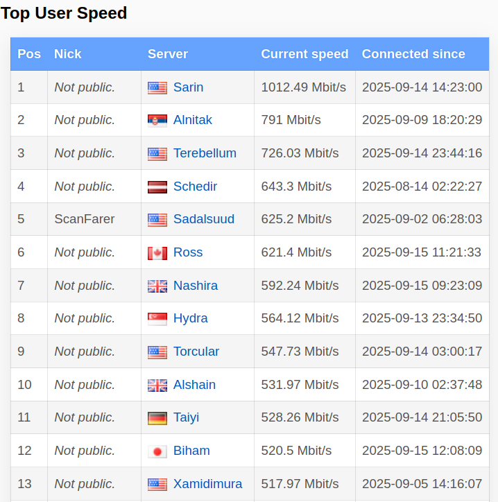

7 hours ago, dIecbasC said:
Migrated from OpenVPN to test some Wireguard speeds this weekend.
pfSense 24.11, IPSec-MB enabled, Xeon-d 2100, CPU load ~40%. Limited by Frontier's fibre gigabit connection.
How do you make your download speed visible at the top user speed on that section? I couldn't find and answer to that anywhere. Reaching speeds well above anyone there, but still not on that list for some reason.
3 hours ago, pukiman said:
That's an average speed over several minutes.  So doing a speed test with ookla, for example, won't be reflected there.
Thanks. This works.

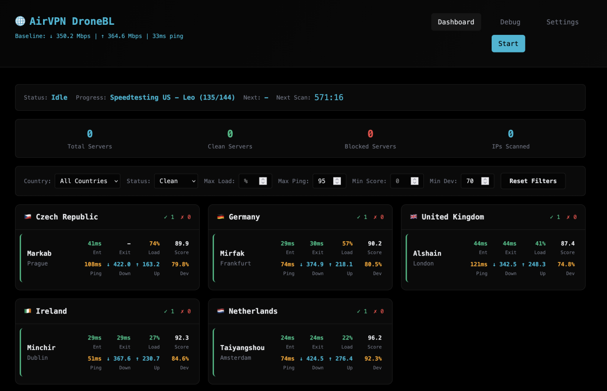

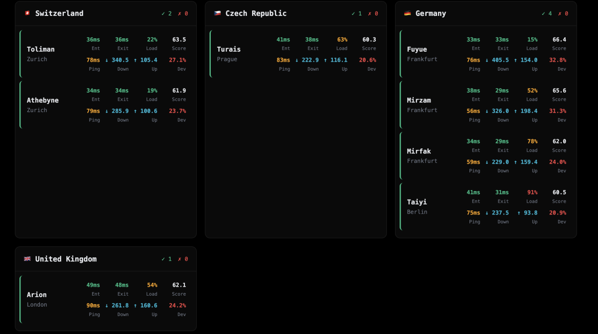

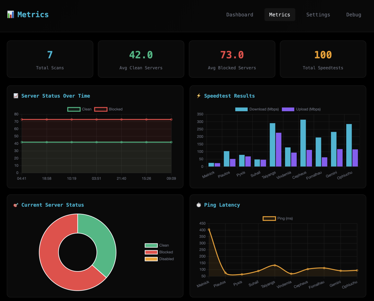

On 12/23/2025 at 8:09 PM, Hypertext1071 said:
@Esurient, what software is that? Looks cool!

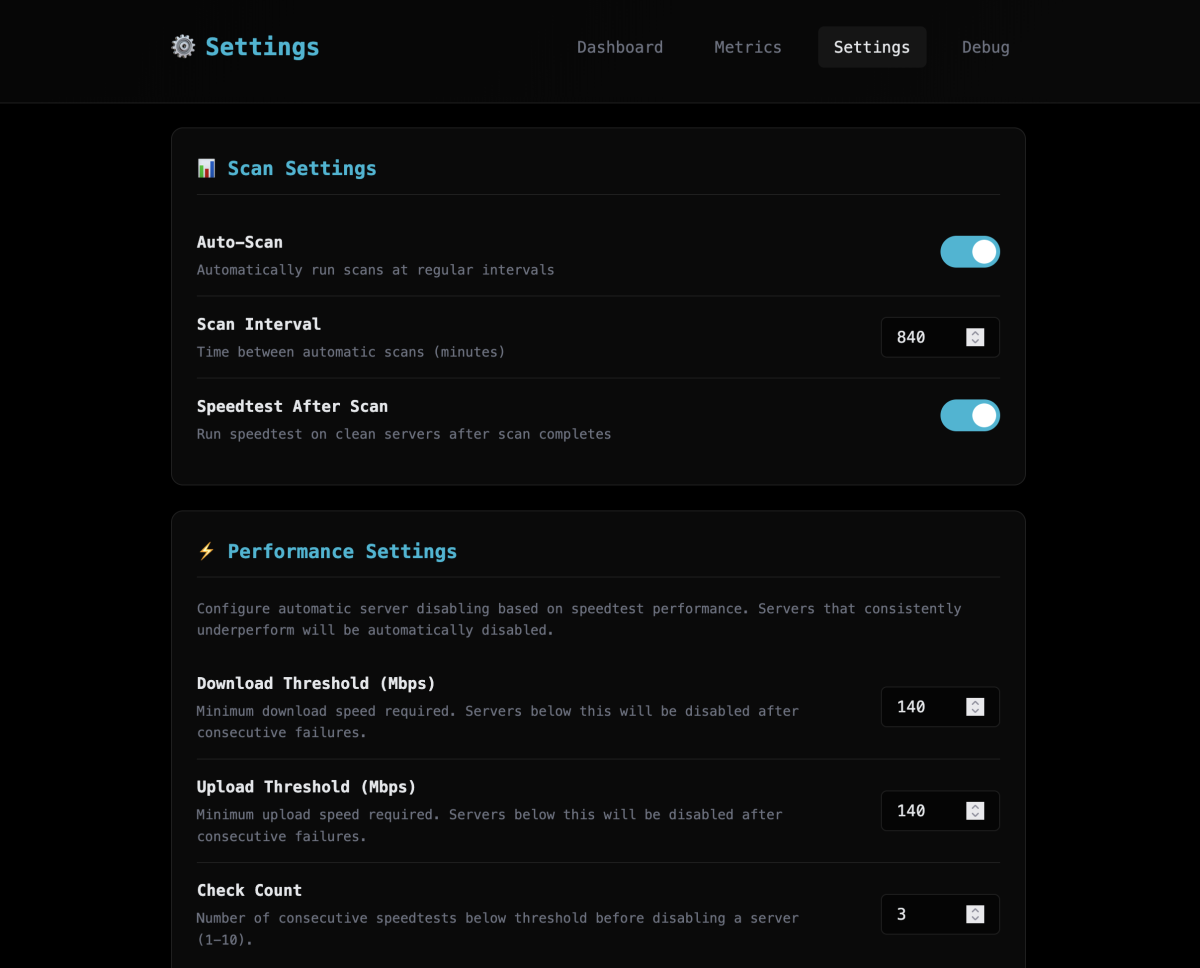

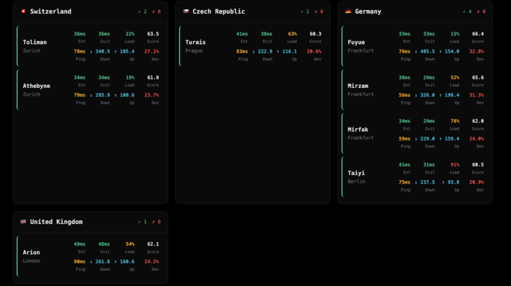

AirBL, docker container for VPN DroneBL checking and VPN testing (optionally), built it myself, been using it for about a month now.
Uses generated WireGuard profiles to periodically speedtest the servers (timer based) with active filtering and banning of under-performing servers, helping you choose the best servers for you with a built in wait timer between tests so that it does not max out your connections.
Filtering for conf files, countries, regions, cities, specific servers, etc. Auto-blocks speedtest servers that fail to connect, chooses nearest server, makes this persistent for that country for all tests and future tests until it cannot be connected to.

Are you still working on this?
Or do you plan to make it open source?

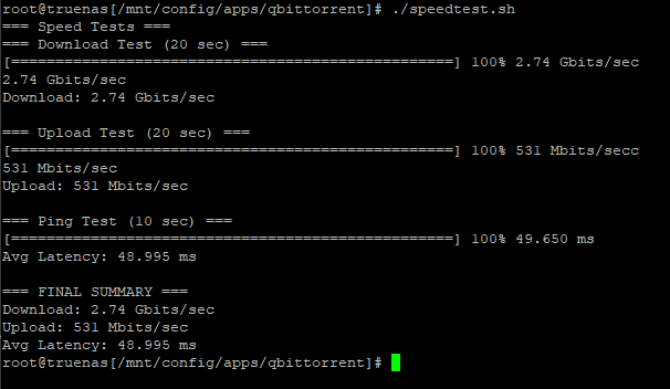

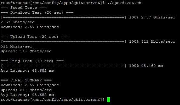

Hello all!  Just asked for a trial account with the sole intention of trying the Canadian servers.  I have 3gbps fiber internet here in Ontario (but I am limited by 2.5gbE ports on my motherboard anyways, and there is overhead at such high speeds)
I got excellent results on Castula, better than my previous Big Brand VPN which is set to expire soon
Just gonna try a couple more servers but looks great so far.  Not that I ever need speeds even remotely close to this, but it's cool to see it IS there

Still working on it, probably release it when it's good enough
