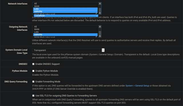

DNS resolver:

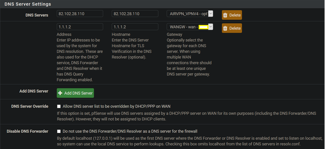

General Settings> DNS Server

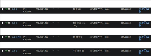

Firewall Rules:

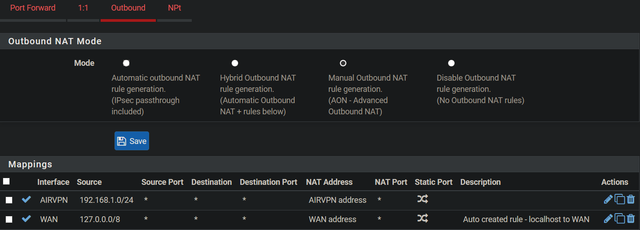

Firewall>NAT:

if you wonder why I use my vpn gateway address for dns server, check out https://airvpn.org/specs/ under VPN DNS server. It also kind of explains why AirVPN does not support DNSSEC https://airvpn.org/forums/topic/852-airvpn-does-not-recognize-icann-authority-anymore/
You could also use 10.4.0.1 instead

Can you post a screenshot of your outbound NAT configuration? It definitely sounds like your LAN is not routing through the tunnel, but since the tunnel is up, it can utilize the DNS for AirVPN as you likely configured that on the DNS Resolver settings, without routing your traffic through it. Also, a screenshot of your routing/gateways setup. You can obscure the IP's for this one if needed. I just need to see if they're setup properly.
