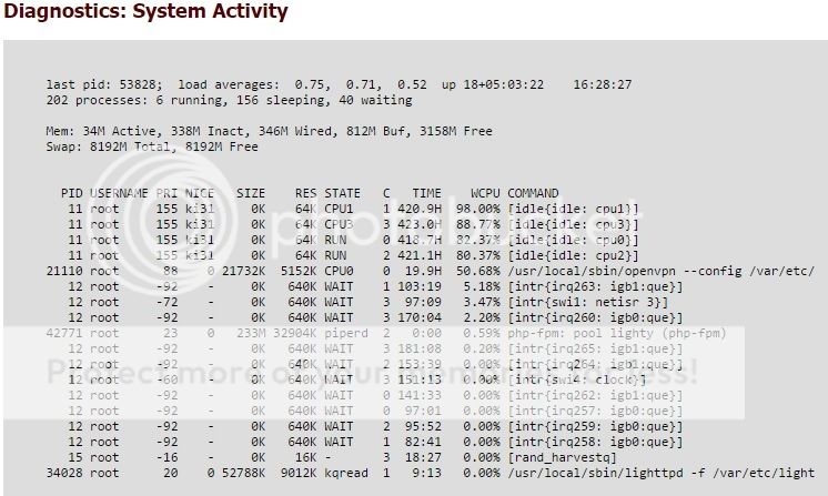

@cpu usage
The point was openvpn is single threaded.
If you want to actually know what's going on ssh into the pfsense machine and run top or something.
Better yet, Do what zhang888 recommend while ssh'ed into the machine and run top.

Ok so I downloaded the client and it does look like I'm getting the full speed with the client.  However it doesn't look like it's the CPU in my pfSense box that is limiting me.
So the question is, is it something in my config.  I confirmed I'm using the same cipher (AES-256-CBC) in my pfSense OpenVPN config as the Windows client is using.  Is there something else I should be looking at that could be causing the slowdowns?
EDIT:  Ok something strange is going on.  I tried changing the Auth Digest Algorith in the pfSense OpenVPN config (SHA1, SHA2-256, etc) to see if taht was the issue but ever since I changed that and forced the connection to reset my speeds are CRAWLING (I'm talking 1Mbps) and even changed it back to where I had it originally (SHA2-256) does nothing.  Not sure where to go from here.
