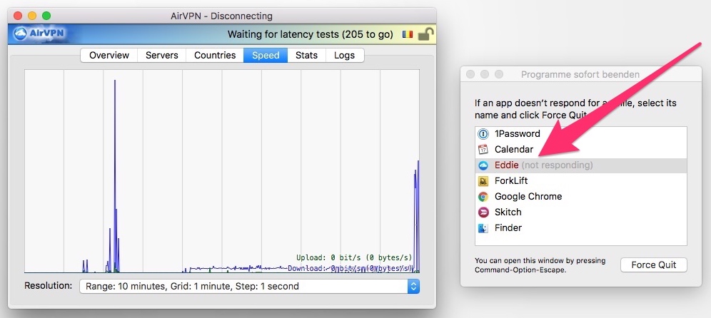

spinmaster 31 Posted ... I have the same issue for a while ... which is quite annoying. Running macOS 10.12.5 and Eddie 2.12.4 ... after my Macbook went to Standby and I'm logging in again, Eddie is frozen ("spinning beachball") and I have to force quit the app to start Eddie again. Any input from the Staff on this? Share this post Link to post

zheshibushibi 2 Posted ... Just chipping in to say that I have this problem with Eddie hanging, and it isn't necessarily after long periods of use or after sleep. On one occasion, I launched Eddie, connected to a server, disconnected a few minutes later (I'm in China and often need only short connections), then after a few minutes Eddie froze. My machine didn't sleep or go to screensaver during this time. It does seem to have something to do with the ping times being enabled. However I can't really turn them off permanently since my pings vary wildly from day to day and my situation (China) requires frequent switching of servers. Appreciate all the efforts from those making scripts. For those recommending a downgrade, I'd reply that this has possible security implications. 1 submergency reacted to this Share this post Link to post

amazeballs 2 Posted ... I also have the same problem with Eddie. Latest macOS. I have to Force Quit Eddie every time I wake my Mac and then restart the app. It is a PITA - not on a 'solving world hunger' sort of level, but annoying none the less. Share this post Link to post

Staff 10493 Posted ... Hello! All the persons who experience this problem can test Eddie 2.13beta now. Kind regards 2 mikeappell and spinmaster reacted to this Share this post Link to post

Keksjdjdke 35 Posted ... It looks like the latest beta of Eddie fixes this issue.https://eddie.website/download/?platform=macos&arch=x64&ui=ui&format=installer.pkg&version=experimental&r=0.38617496202415824 1 spinmaster reacted to this Share this post Link to post
